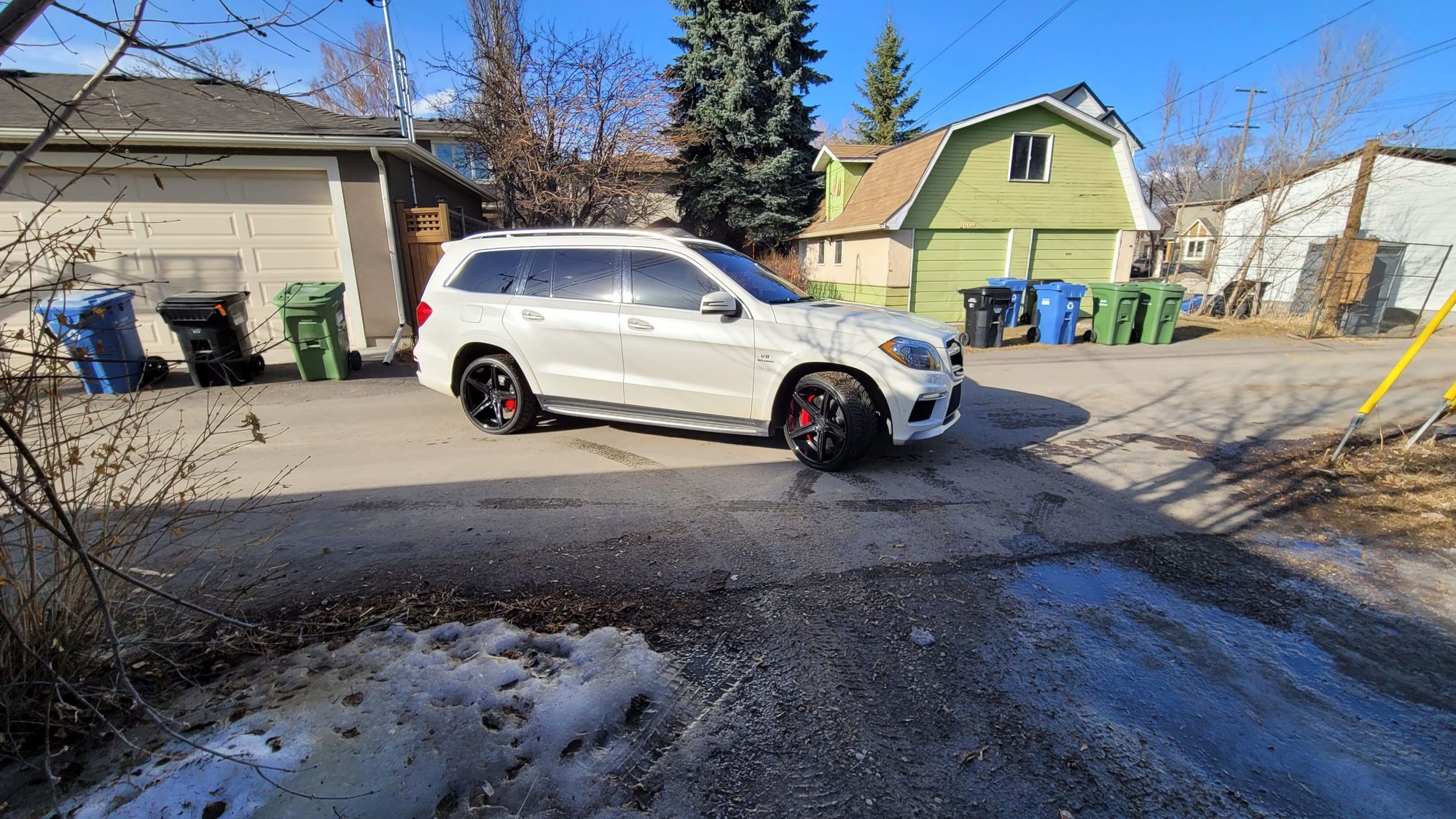

22 x10.5 square.
3mm spacer to clear front brake
295/30/22
