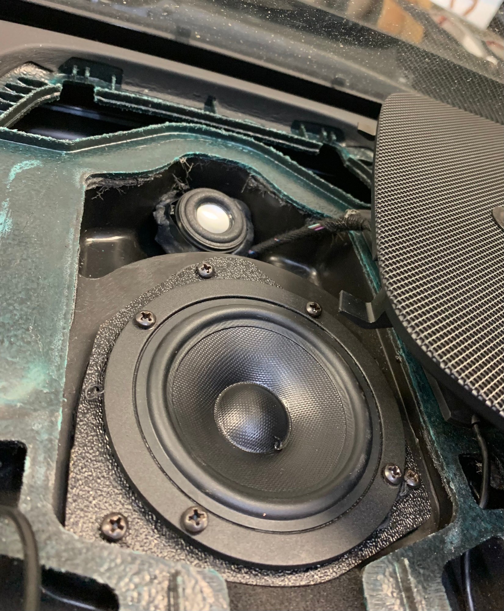

Massively easy upgrade. Slightly better staging after upgrading the center speaker.
Specs on the original:
1) cover pops out, and speaker also pops out with no screws
2) it’s a 100mm dual voice coil speaker, and each coil is 8ohms
3) one coil plays audio, the other coil is separate from the audio system and plays the mbrace audio
coil with blue plug is stereo audio
light gray wire -
light gray black stripe wire +
coil with white plug is mbrace
gray black stripe +
brown black stripe -
made an adapter out of abs for a 100mm Scanspeak Discover 8 ohm mid range speaker for audio
added a 1 inch full range 8 ohm speaker for m-brace
(all purchased from Madisound)
