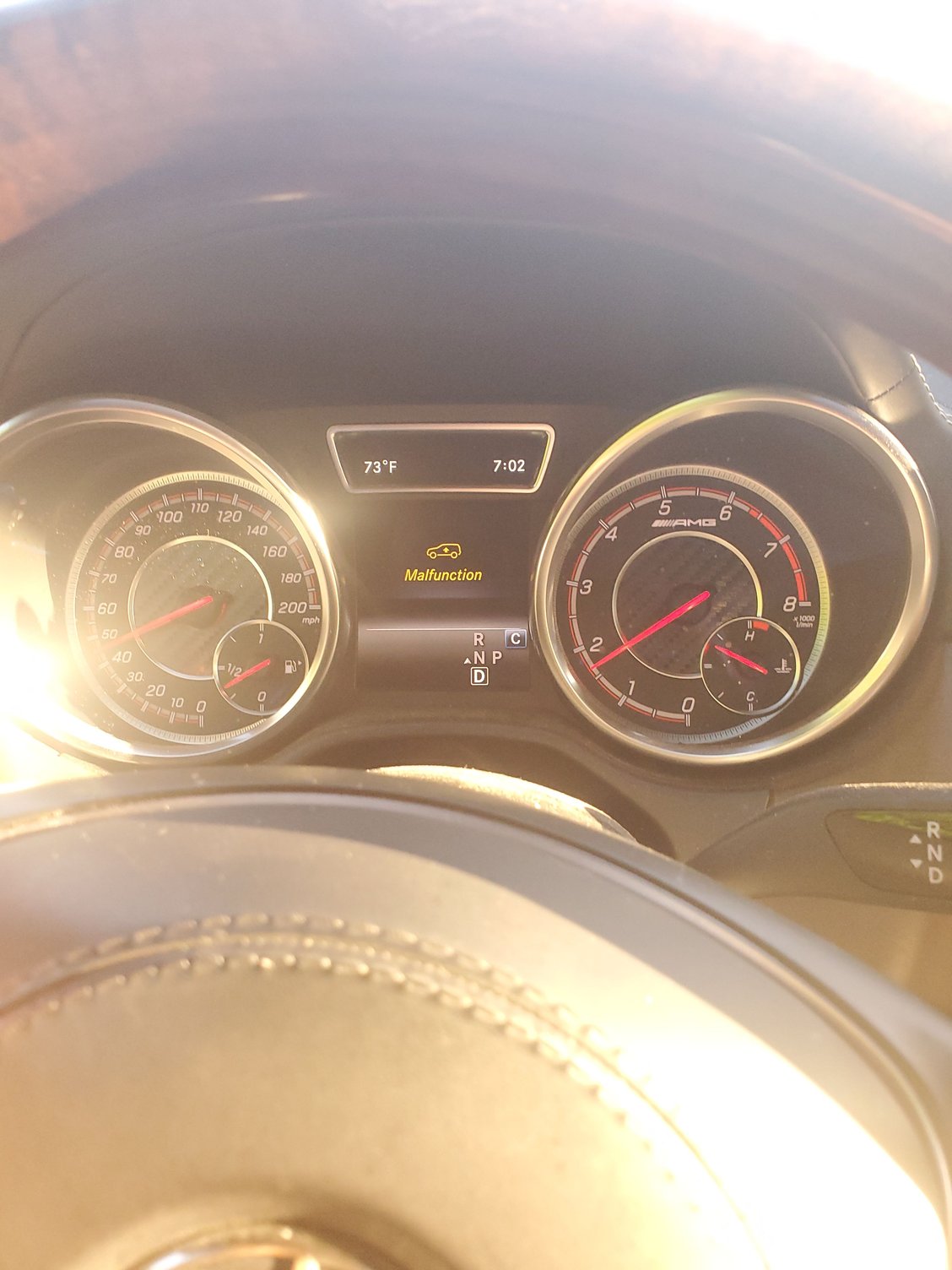

2018 gls 63 with about 90k on the clock. Recently had the air suspension failure notification come on so that the car was riding on the lowest level, not inflating the whole day when I was driving it. Next day fine. 2 days later again the whole day. It's been fine for 3 days since then. I assume this means the compressor is failing? Bringing it to dealership on Tuesday. Now worried they will refuse to repair if it's not failing when I bring it to them. I'm aware the lifespan of this system is about 100k miles. Warranty is up at 100k. Should I insist they replace it? It's not like this is going to get better otherwise.

Probably have leaking strut/s and the compressor is now fried due to overheating. Yes, take it in for repairs under warranty.

They found 1 strut leaking air and will replace that. Couldn't convince them to replace the rest even though will undoubtedly fail. Hopefully they fail in the next 12,000 miles before warranty's up!

I always replace in pairs for that reason. The other one will fail soon but Murphy's law states it will fail at 1 mile after the warranty is up. Seems to be my luck too.
