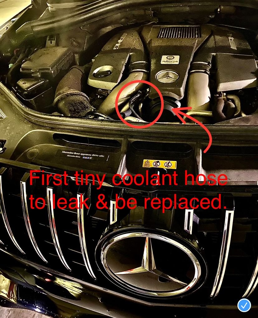

  • Small coolant hose (picture attached) was also replaced due to a slow leak.

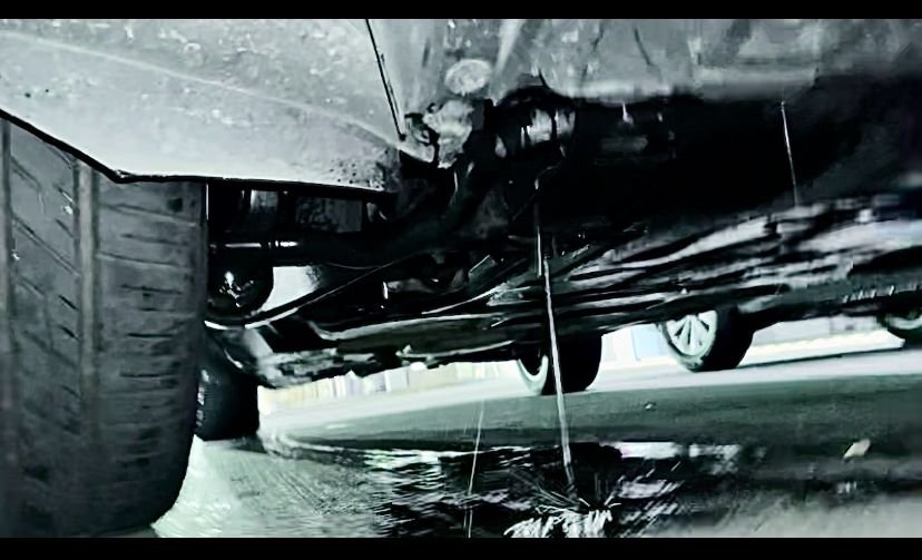

Within 2 more miles (as I was about to arrive to my destination 4 total miles from home) I received red warning light, saying something like “Turn Engine Off -Engine Hot”. I parked and got out to find coolant pouring (multiple streams) out under the front passenger side of the vehicle. MB Roadside picked it up to tow over to the garage. Any ideas what this could be?

    Coolant pouring out underneath on passenger side.

My guess is it's 1 of the 3 small turbo coolant lines. They are plastic and very brittle.
