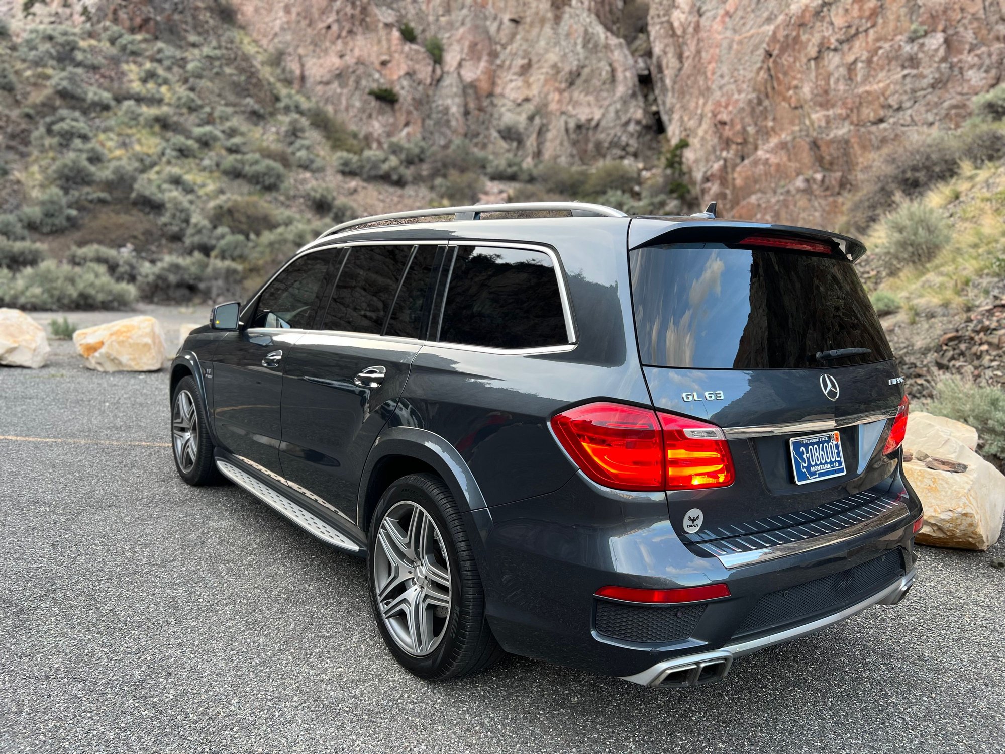

2014 gl63 amg 80,000 mile service recomrmdations
I purchased a second owner gl63 amg that has been serviced every 5000 miles by a non Mercedes mechanic. No issues leaks or codes therefore none of the Mercedes recommended services besides oil n air have been completed. What are the majors that need done asap?
