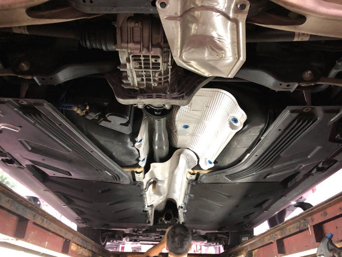

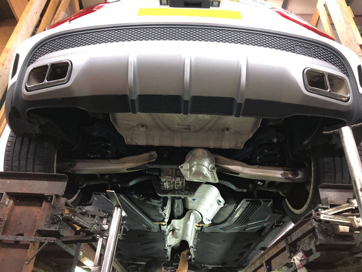

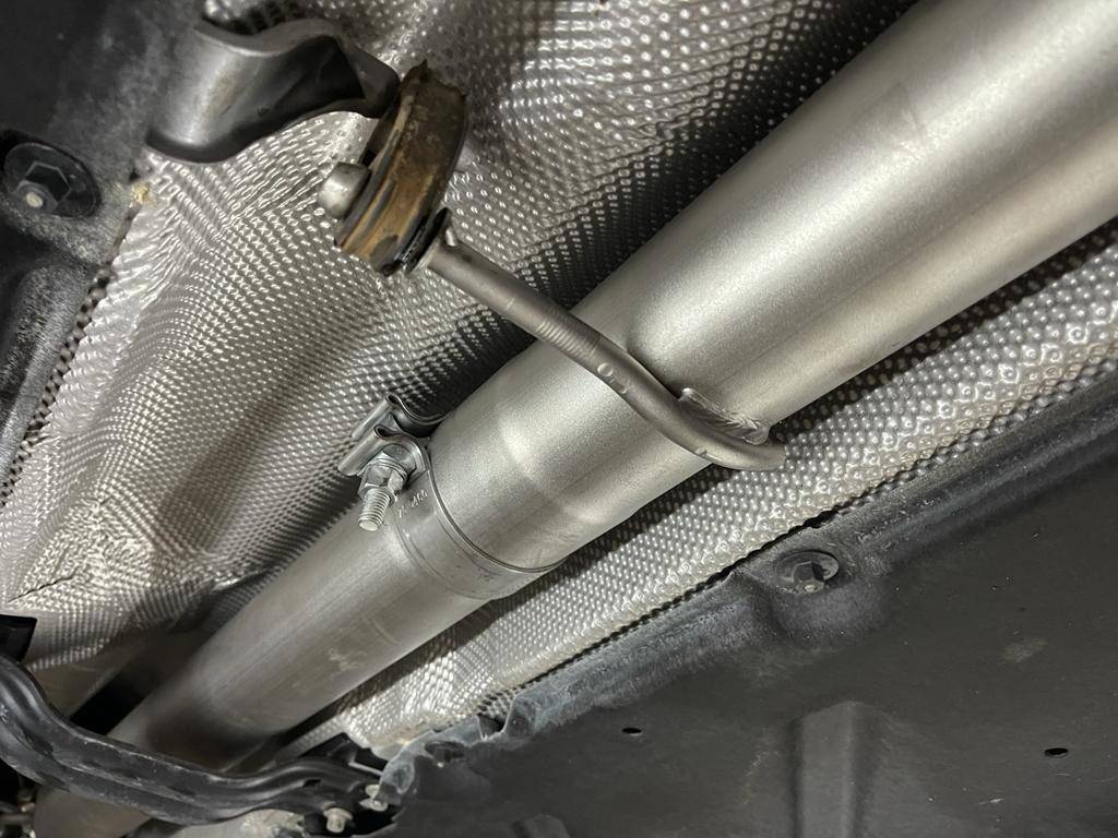

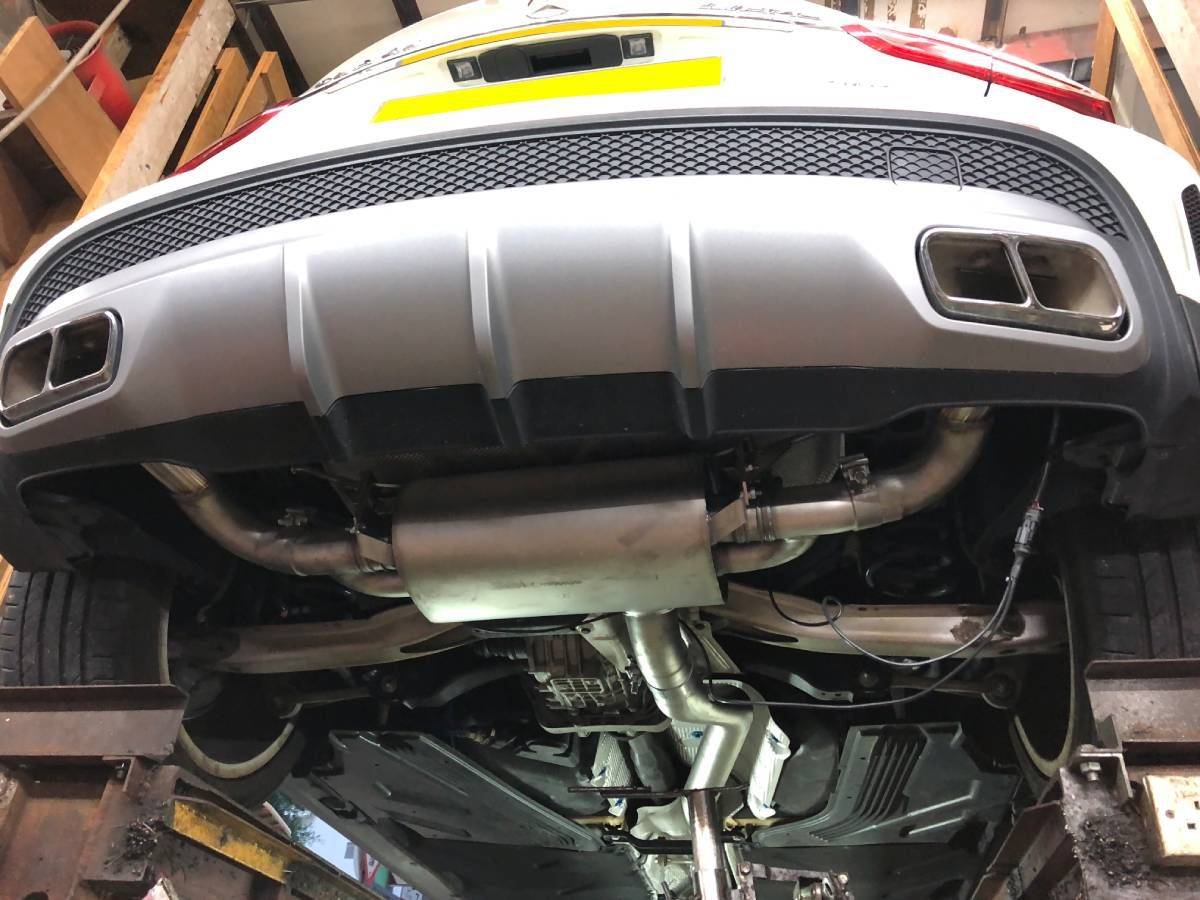

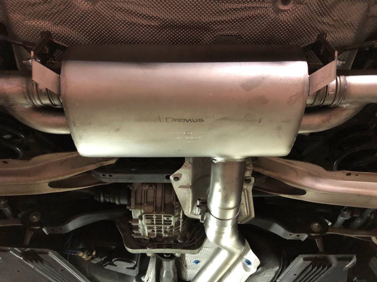

Exhaust upgrade for this pre facelift X156 GLA45 AMG. Remus Cat-back exhaust was chosen this time since this exhaust works perfectly with the stock catalytic converter, and also increased quite a lot of power and torque.
The most attracting feature was of course the signature REMUS sound.

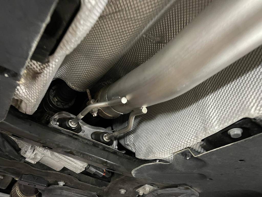

Stock exhaust consist of one valve on the right as shown. New muffler comes with two actuators, one on each side which can be easily connected by the provided extension cable,
The actuators works exactly the same as factory presets via vehicle onboard electronics.
The only modification has to be done was to extend the end tips of the muffler.
