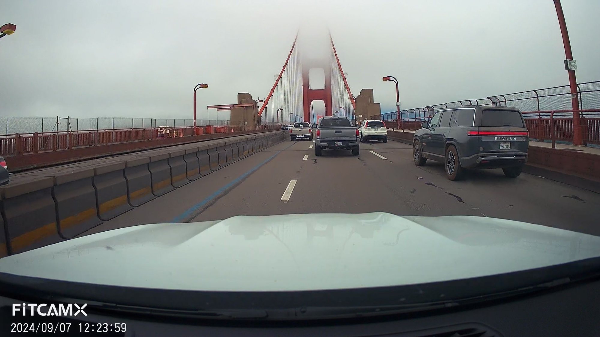

Hi
I've just installed FitcamX on my 2024 GLB35 and it is so far pretty good. It can record both front & rear video in 4K resolution as well as sounds. When you connect BAT+(always ON) from the fuse box instead of utilizing the rain sensor connector(default), the cam starts recording with an inpact even when the engine is off.
GLB35 in SF

GLB35
I also struggled with cables of FitcamX and ended up asking a body shop to tuck them. They did nice and no cables are noticed at all. I did not see any heat issue so far on it but I had some issues on the rear camera recording. I asked FitcamX support and after installing the latest firmware, it's working fine.
