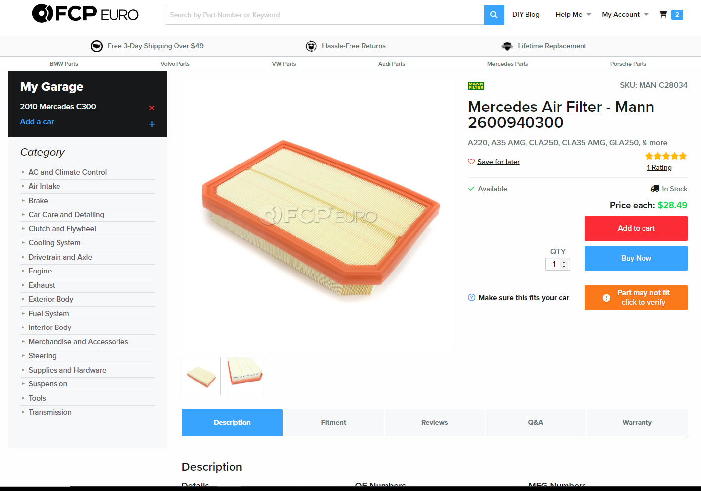

Found video on Youtube to change engine air filter, without removing computer harneses or disconnecting any ducts.
It is really easy and only took 5 minutes to replace the filter. All you need is T20 Torx bit, to loosen 4 screws.
Purchased Mann-Filter Model C28 034 on ebay for $35. It is exact same filter that MB uses as OEM. Ebay, Amazon, Parts Geek and other sites sell it around $35-$40.

Thanks for the video. Just to confirm do these steps apply to the GLB model? Mine is from 2023. Also is this for replacing the filter for the cabin air?

Can always buy from FCP then return it under the lifetime warranty. Get the cabin filter, oil filter and windshield wipers at the same time to get free shipping. It will probably cost around $10 to ship it back. Receive store credit for original purchase price.

I have 2021 GLB and steps are the same.
This is for engine air filter not cabin air filter. You can search youtube for cabin filter replacement videos. Not complicated process. The cabin filter is below glove compartment.
