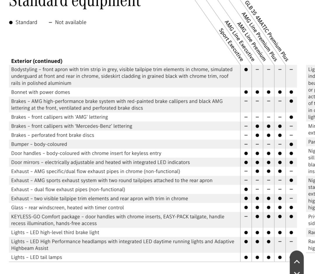

On line brochure shows all models have heated mirrors
