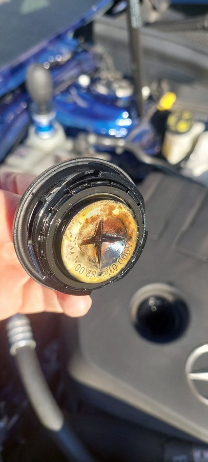

Well back to original problem of low coolant message. As I said I've topped the reservoir up with about a cup full of water. I then checked the oil filler cap and there is traces of "mayo" on the inside. This could be condensation but I'll keep an eye on it. By the way I have the 1.3l engine (M282)
Do you have any indication of overheating? Coolant loss and mayo in the oil maybe indication of a head gasket leak, leaking coolant into the oil.

Tried a gas analyser test in the expansion tank and liquid stayed blue so doesnt appear to be emission gas in water
Oil cap has some
Oil cap has some "mayo" in the cap but could this be condensation? Note water temp gauge is normal at 90
