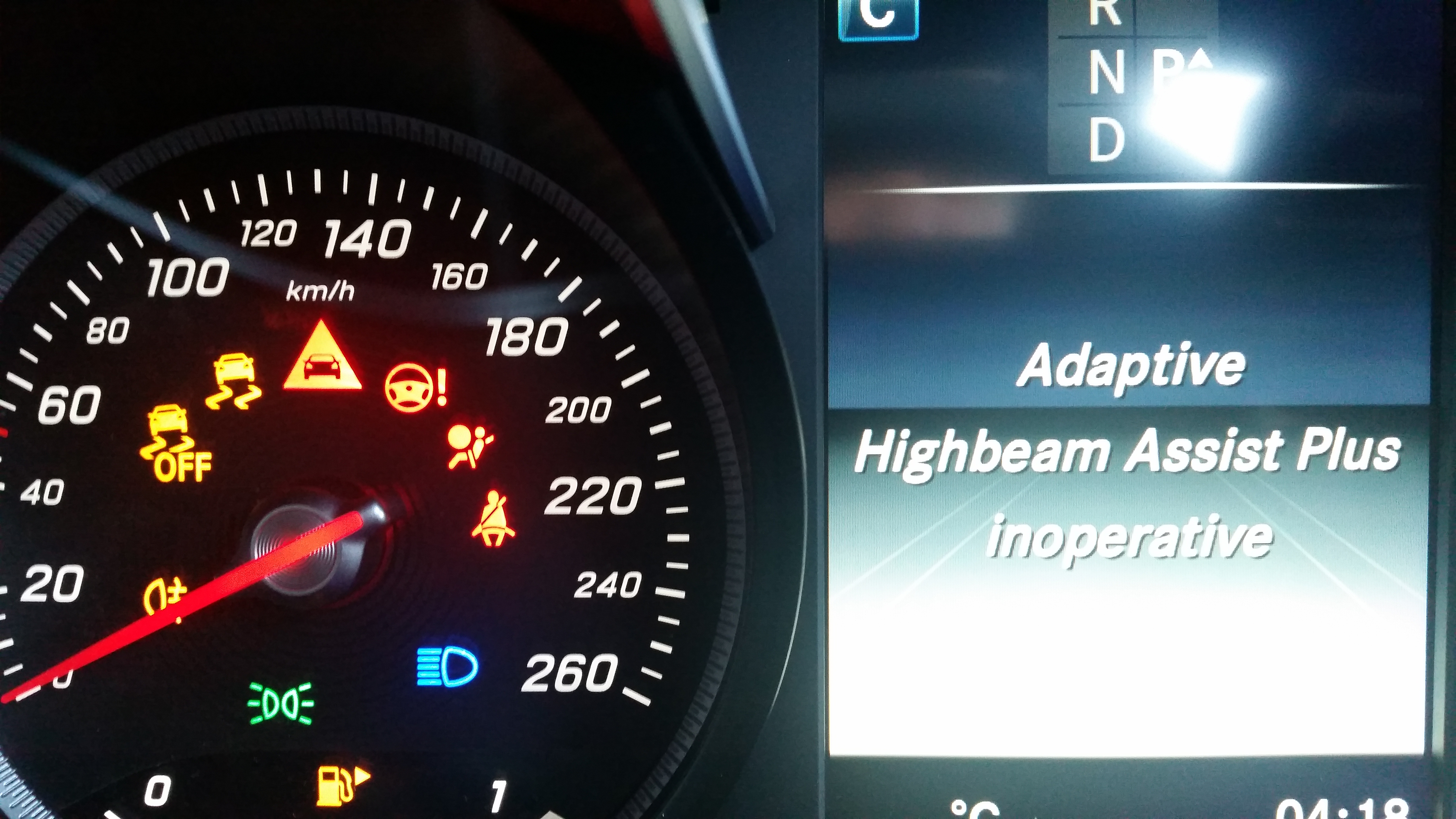

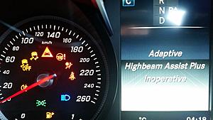

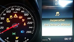

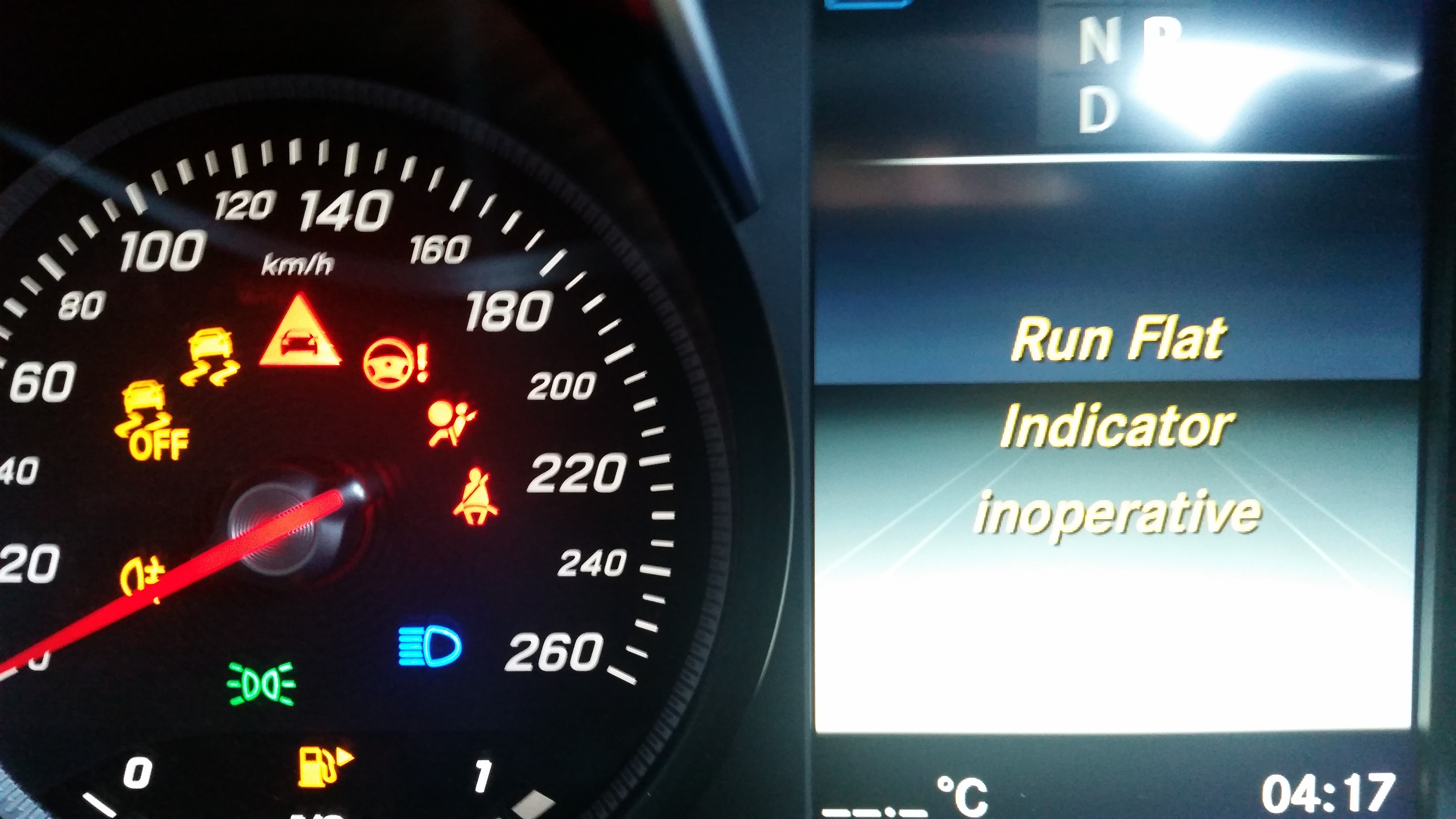

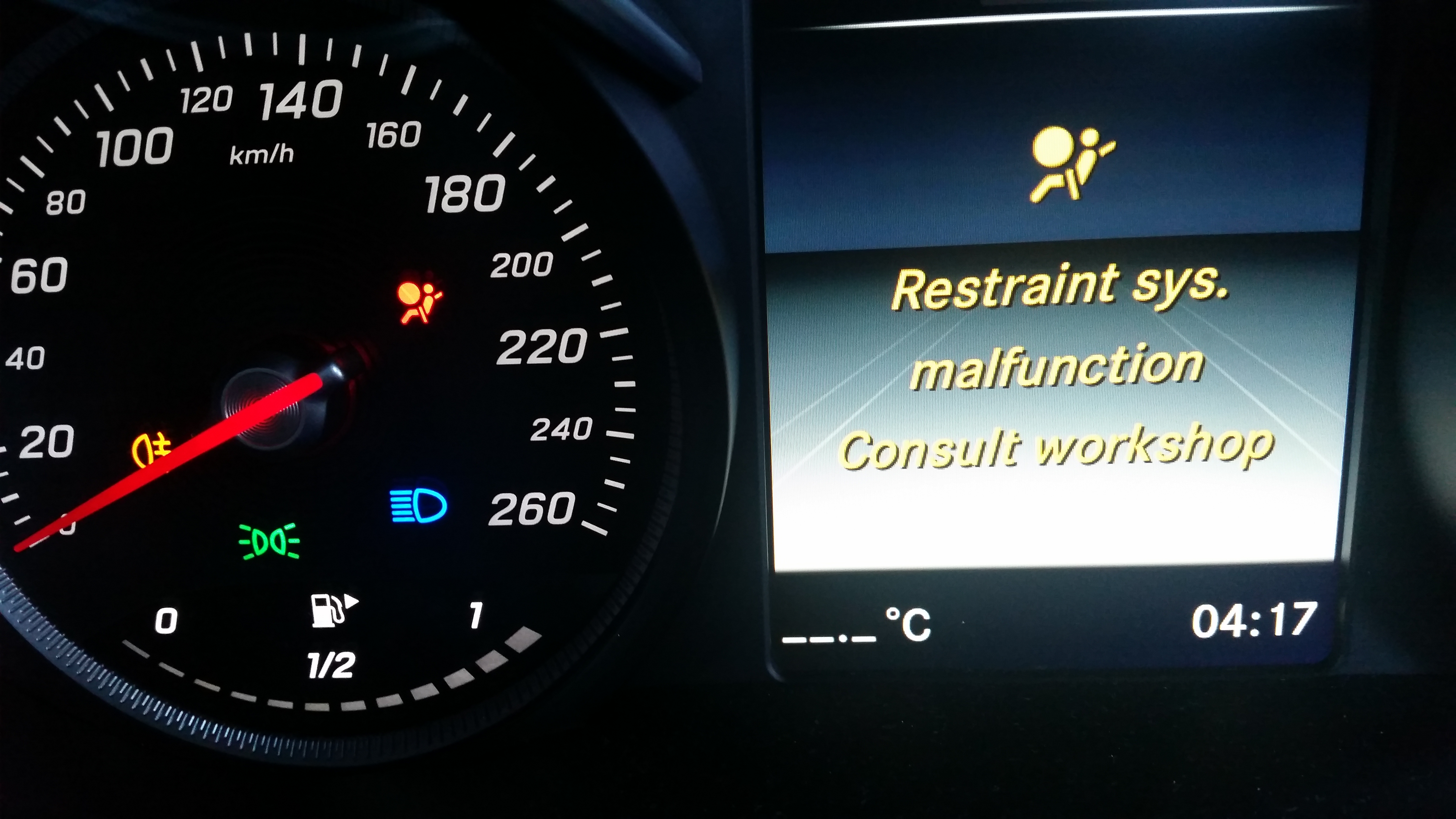

My GLC stranded me in a car park where it refused to start. Lots of warning messages and the engine would not turn over. Had to call MB assist to get it started. I visited the dealership where they cleared a lan-bus fault with the passenger airbag system. The service manager also confirmed that the GLC will not start if any safety system is inoperative.

The worst part is that the fault locks the steering and locks in the car in park. The service manager confirmed that GLC's 9 speed transmission does not have a hidden manual release mechanism.

Tron786 may have a valid point here. Okay, a crazy signal out of the normal range expected from, say, a throttle position sensor should cause a global fail-safe shutdown, no argument here. But -- as noticed in Penn's thumbnails -- should a bad signal value from a "lane keeping" or "high beam assist" sensor also disable the entire car? I hope not. If so, I'm on the side of Tron786 with the fewer the sensors the better.
