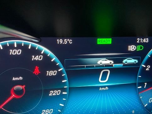

1)How do you actually use Distronic in stop&go/city traffic? Even some step by step guide would be nice

2)Distance settings:
I don't get what each of those markings represent? I couldn't find it in manual, I can't find in MBUX what each step represents? How much meters/ feet is each one? I have 4 in total.

1) I use the single car length setting on Distronic in stop and go traffic and in city driving. I use 3 and 4 setting while driving at speed on the highways.

The distance settings are car lengths.

1) Distance is now clear, would have never thought that this is cars distance. So 4 lengths is how much? Around 20 meters/65 feet? Isn't that too low for the highest range? Because I see more than 50 meters graph when I turn it on. Does it depend on highway vs city road? Can I find some more information somewhere ? : ) How did you find out it is car lengths?
