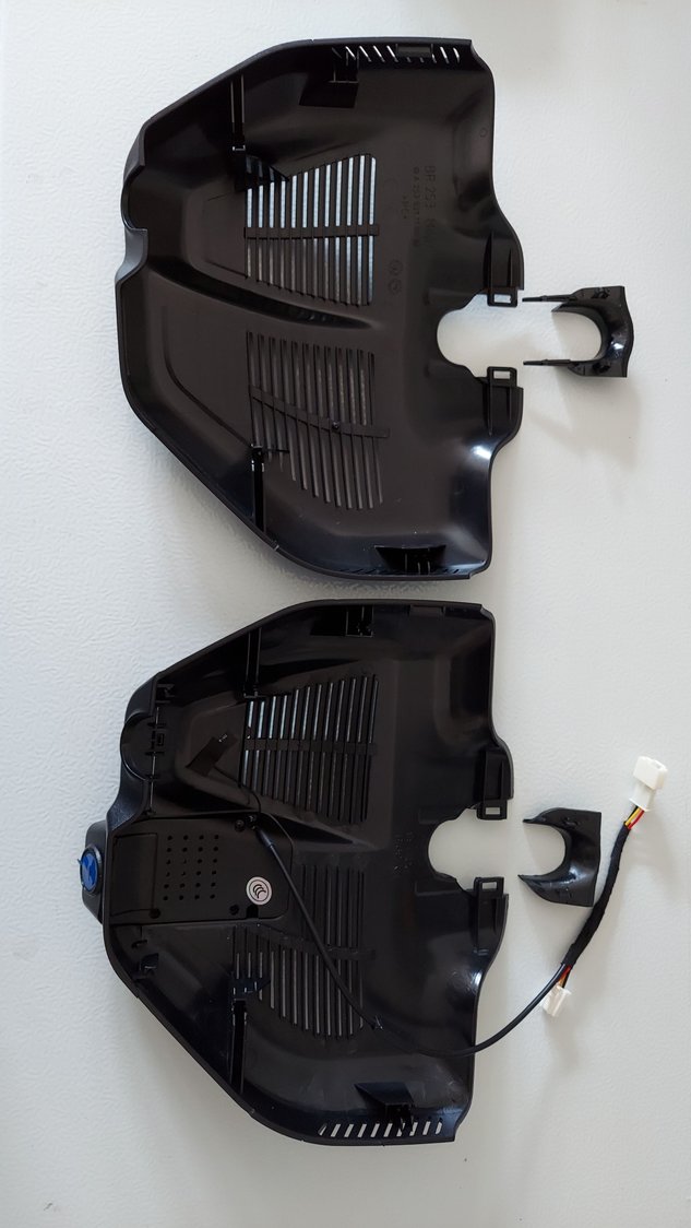

About a month ago I purchased a FITCAMX (https://fitcamx.com/) integrated dashcam. This dashcam is mounted in a housing designed to replace the plastic housing mounted in the upper windshield behind the rear view mirror(see attached photo). Dashcam power is provided by a simple plug and play wiring harness which taps the necessary voltages and ground from the rain sensor. All wiring is concealed within the plastic housing. The dashcam has a wifi interface accessed by a phone app (Fitcamx) which is used to adjust various settings, view the camera live as well as review, edit and download saved video clips.
Ordering required taking a picture of the original housing which Fitcamx used to assure the correct model was shipped. Fitcam support was responsive and informative in answering my (many) questions, providing shipping and up to date tracking information. I opted to order direct from Fitcamx rather than Amazon since either dashcam would be drop shipped from China. The Fitcamx direct price was also $30.00 less than Amazon. Delivery from China to Florida took a total of 14 days, arriving via USPS.
Installation was easy, with removal of the existing housing taking less than 10 minutes using the provided trim removal tool. Videos of the installation process abound on the internet and are also available via the Fitcamx app. Power harness installation took some time since my rain sensor wiring was different than any available video. Fitcamx support was very responsive in helping me identify the correct plug to use. (See attached photo)

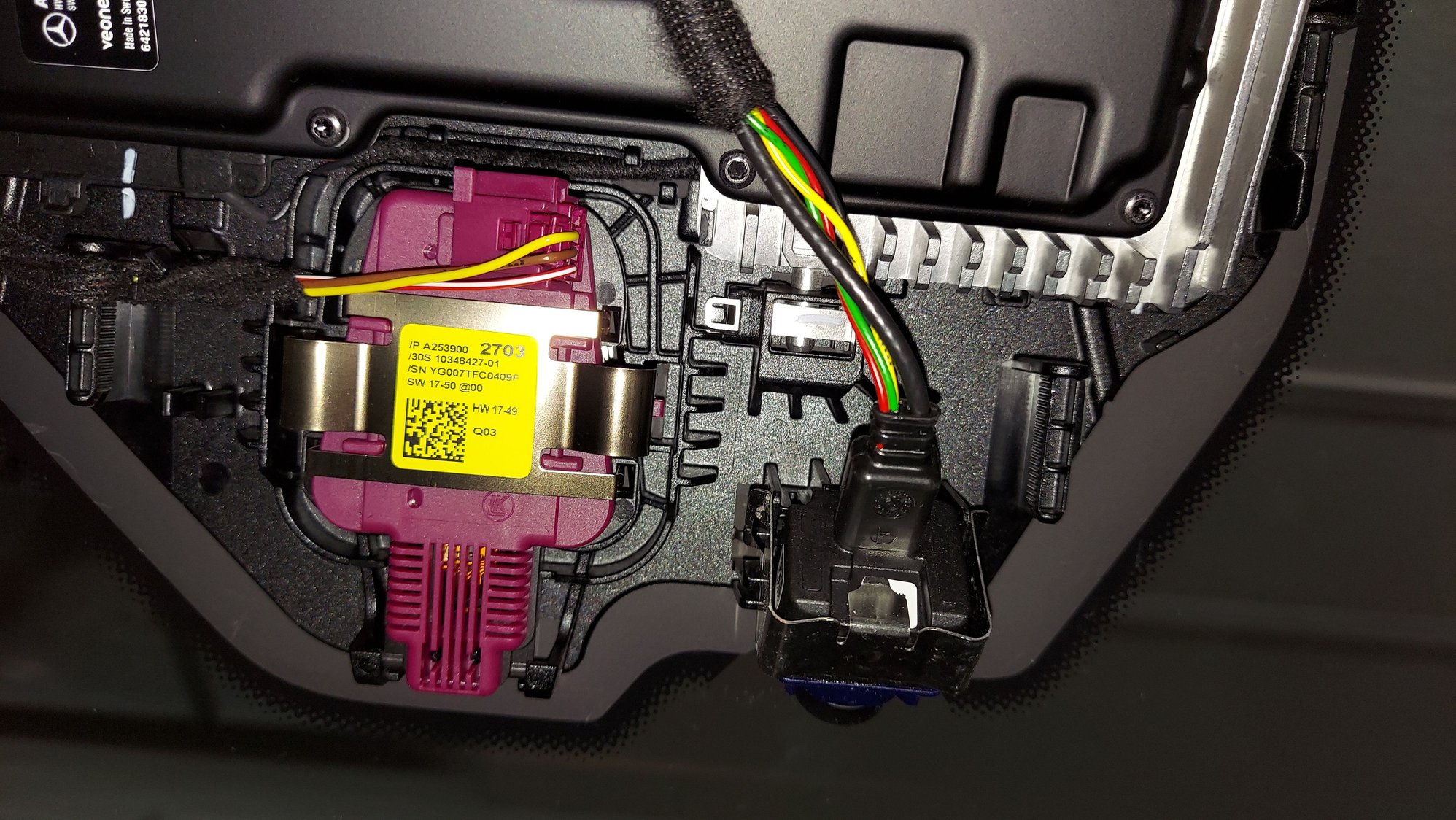

Powering up the car revealed constant intermittent wiper sweeps and the dashcam inoperative. Comparing the wiring of the original rain sensor wiring to the dash cam wiring harness revealed that the Fitcamx plug was wired incorrectly. Emails with Fitcamx support verified the error, the result of a GLC wiring change mid year. I was given four options: 1) return the defective dashcam for a refund. 2)rewire the plugs using their directions. 3) Fitcamx will send a replacement. After verifying correct operation I will return the original. 4) If the replacement fails I will send both units to Fitcamx for full refund. In all of the cases Fitcam would send prepaid return shipping labels. I chose the replacement route.
Two weeks later the replacement arrived. I visually verified that the wiring was correct. Installation and testing took 15 minutes. The dashcam functions as described with clear, vibrant detail. The rain sensor also works as original. The Fitcamx app functions flawlessly. Video quality is amazing at 3840x2160.

Below are photos of the original and replacement housing as well as the rain sensor (pink) where you insert the wiring harness.
Original and dashcam housings
Rain sensor where dashcam harness is inserted (in pink)

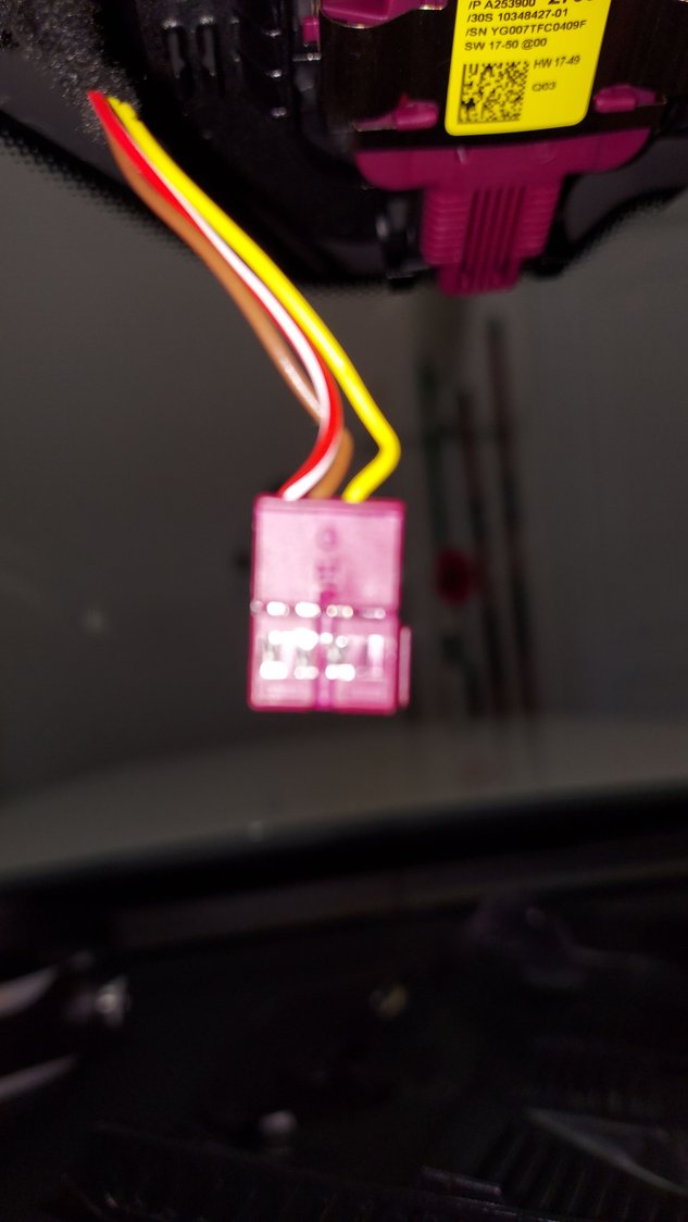

Is this the plug....went back but have lots (too many)?
Old Mar 17, 2024 | 09:48 AM
jj31234's Avatar
Joined: Jun 2018
Posts: 29
2018 GLC300

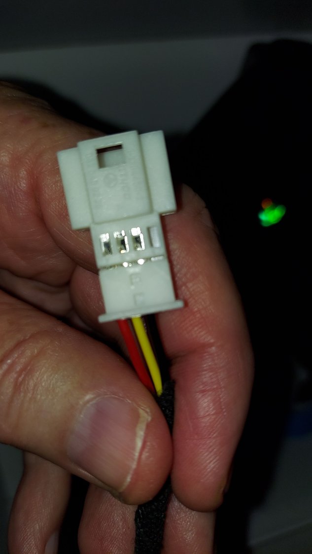

Found pictures of the sensor plug and fit am. Plug. The previous picture is of a different connector in car module.

Hm, thank you so much but that makes no sense. I just tried to wire them like that and both the dash cam and the rain sensor don't even get power. If you look at it, this configuration leaves the red wire out and the colors don't match on the fitcamx connector vs your rain sensor.

update. I ended up changing it back to the original wiring. Red, black, yellow and then CUT the yellow cable going to the camera.
Now the rain sensor works, camera works but camera turns off exactly every 1 minute and will power on a few minutes later and repeat again. I'm giving up.
