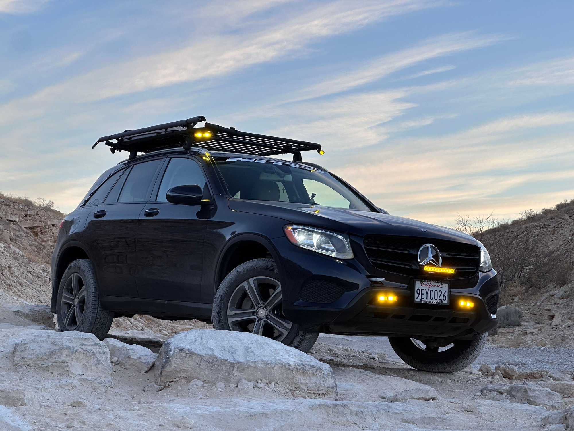

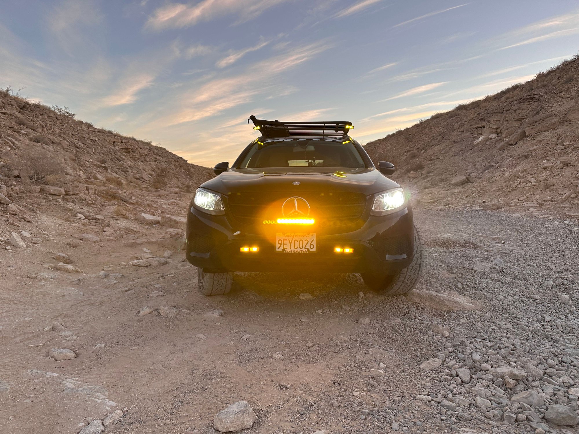

So I installed the TEMA 4x4 30mm lift kit myself and it took some work. You need to get the rear shock spacers with the kit to increase the articulation, because the shock will limit it otherwise. I also had to cut the rubber of the rear shock spacers a bit to make them fit, but other than that, I’m happy with the improved ground clearance. No noticeable changes in vehicle dynamics or fuel economy. Now I’m on to determining the largest tire diameter and width I can fit. Looking at a 245/60r18 or even a 255/60R18.

I was able to throw on some 245/60R18 Nitto Nomad Grapplers that have performed super well on and off-road so far. They’re much heavier than the all seasons I had, but lighter than standard all terrains. The lift spacers definitely did something, but I do wish they were taller. There isn’t much space left, but it still might be possible to mount 255/60R18 if you’re okay with it being very close. I can just barely fit my index finger between the top of the tire and the control arm nut. Let me know how the 17s work out for you!
