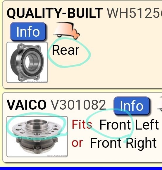

This is not full instruction. I never replaced the rear bearing. But I did the front bearing.

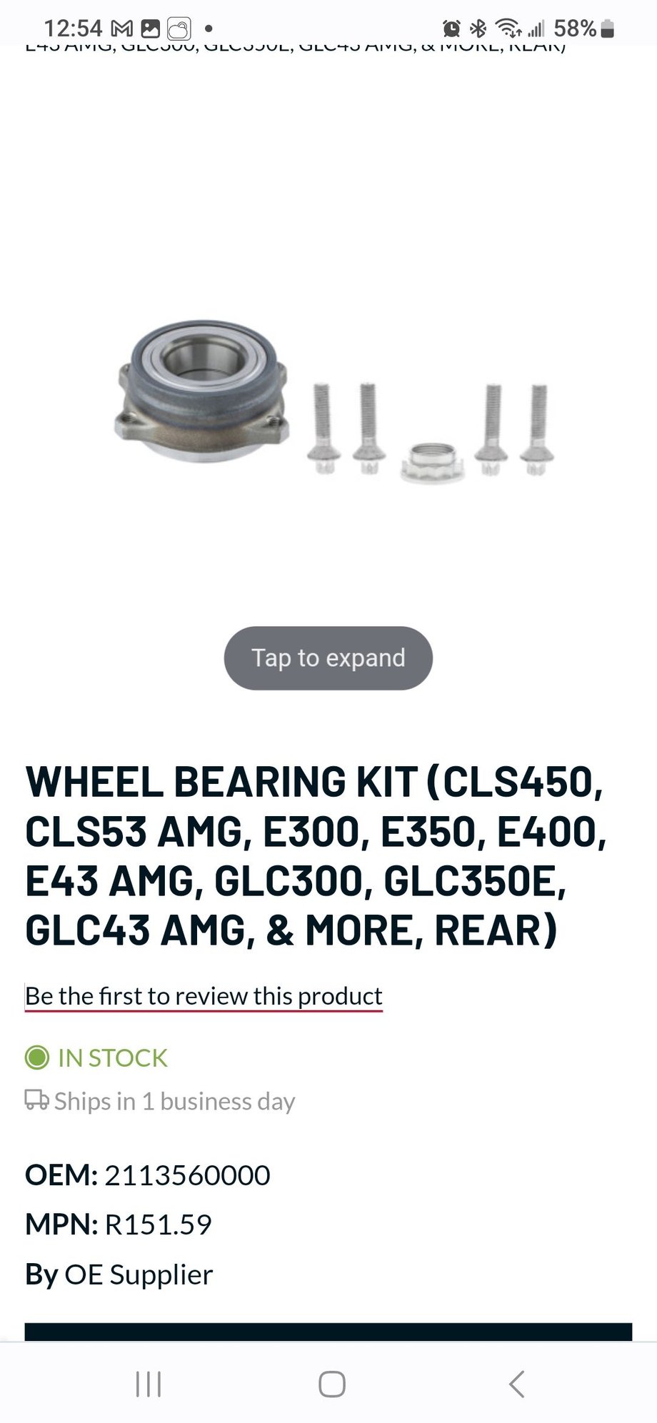

Rear wheel bearing part is selling only bearing. So probably you need to press out the old bearing from the hub frange and press in the new one.
https://www.autohausaz.com/pn/MB-211356000064
GLC300 E300 S450 CLS uss the same part.
when i replaced one of front bearing. I had to hit many times with a hammer and the chisel to detach the bearing from the hub.
I attached the rear picture I took when I replaced the brake rotor.
Hope you find the right video.
Rear bearing has no frange.
Rear
Rear
Rear bearing fit these models.
Rear (my rotor replacing). Hub nut size is 32mm 16 points.
Front bearing i replaced. I need to hit with the chisel.
