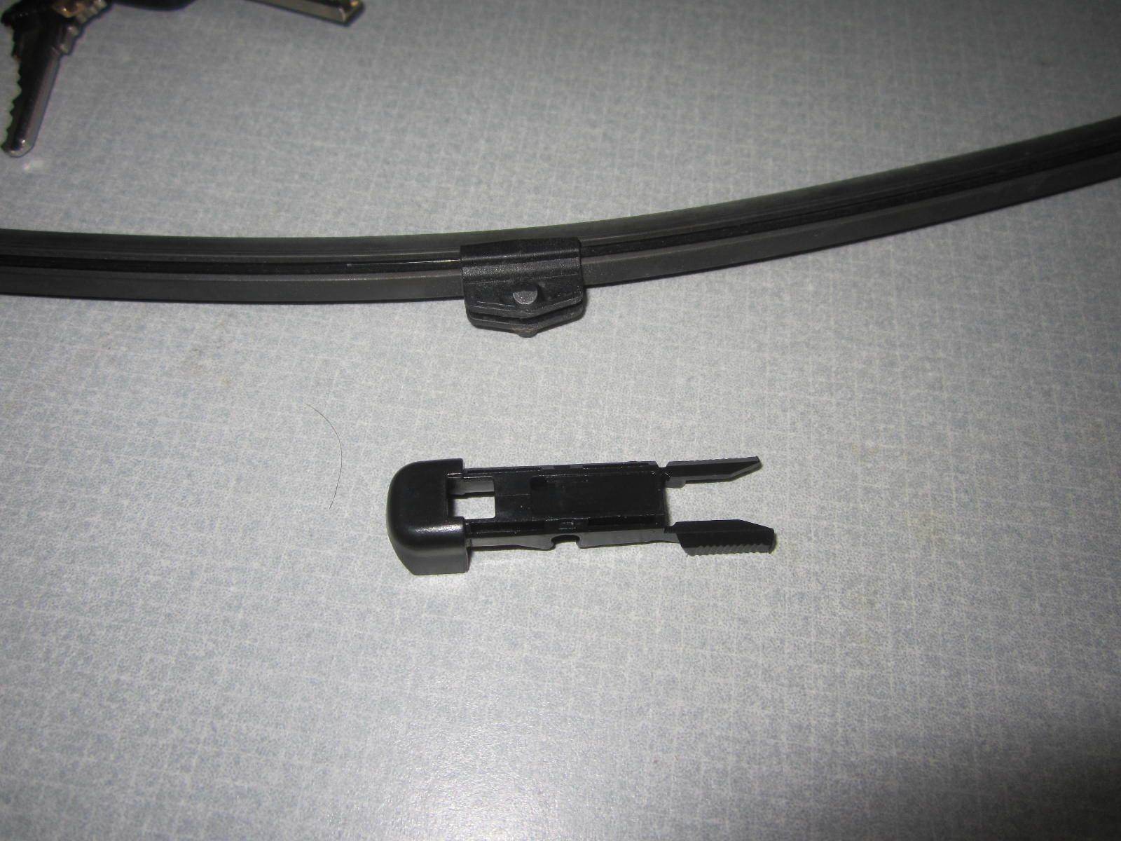

Mine is not like that. I did figure it out. The confusion comes from the aftermarket blade having a clip on it. I looked at my blade and decided to just pull the blade off the arm as I could see how it clipped into the slotted openings. Then I took that bracket off the new blade and it snaps in place. The arm is well bolted to the door with a nut. Will never come off.

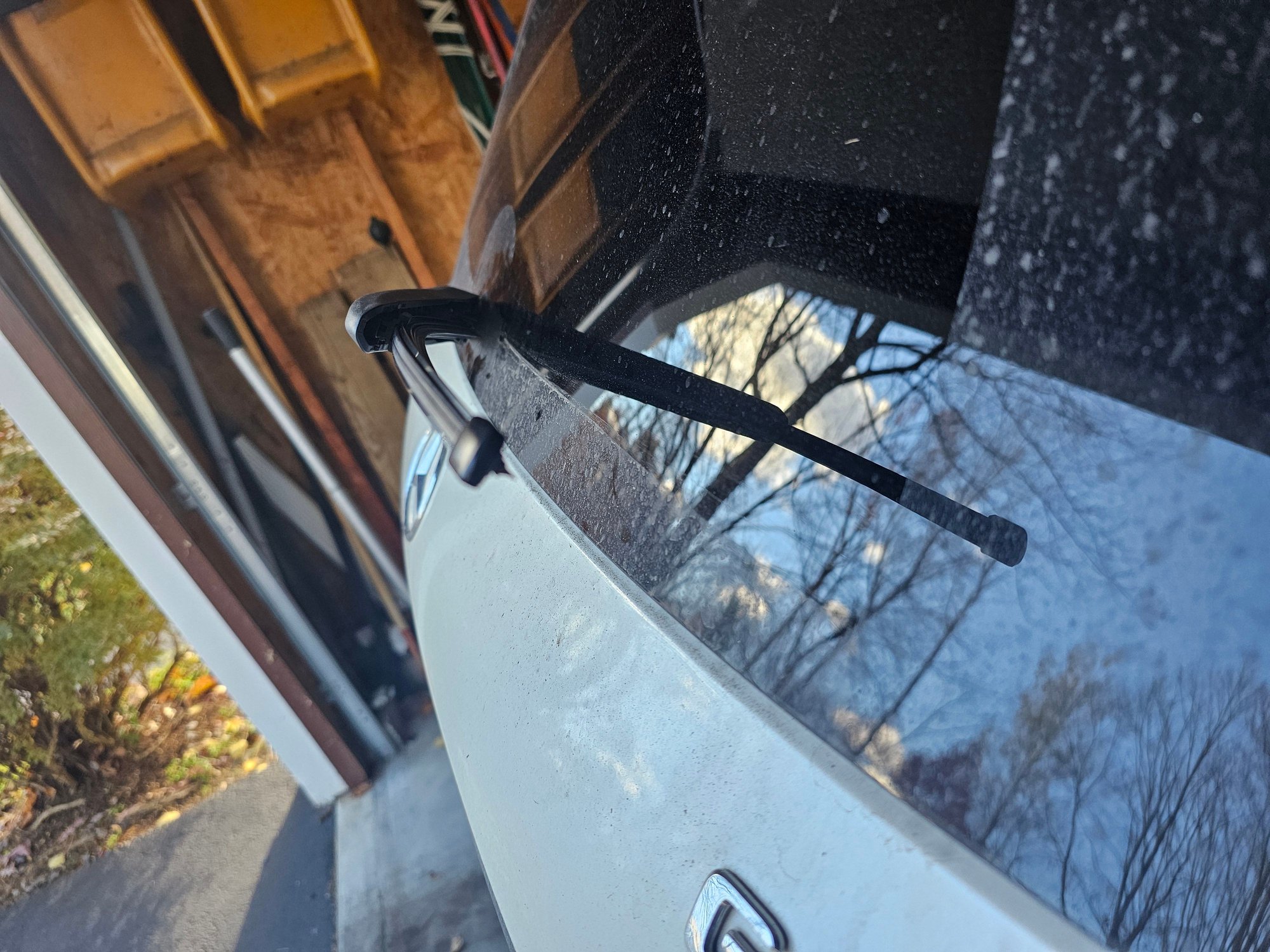

this thread helped me as i was stuck also. But the arm does come off. Once i popped the old blade off i pulled up enough while holding the arm and it locked into place about 3 inches out. Then the arm fell off into my hand because i already had the nut off. Lol
