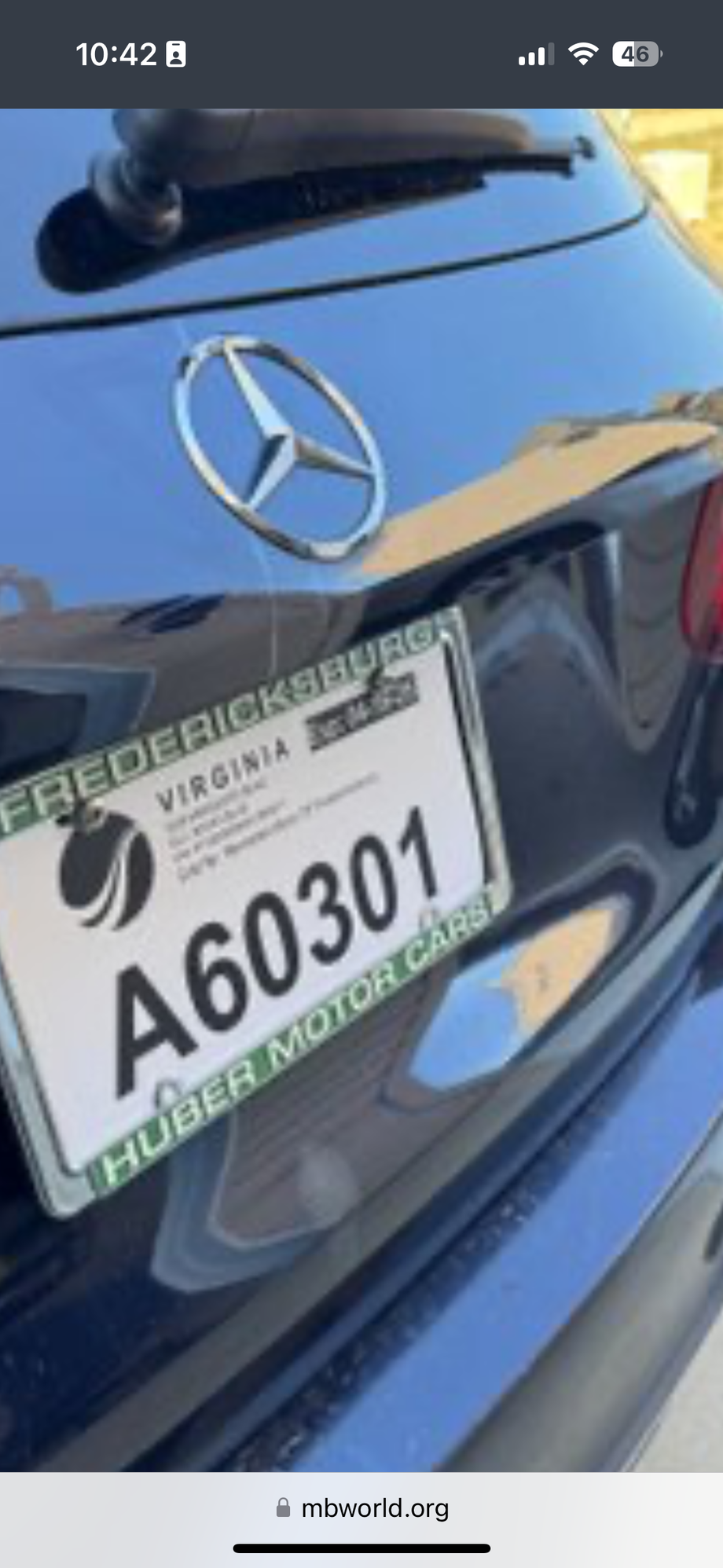

It looks like something spilled next to the logo and the number area and discolored it … just bought the car and was wondering.

You sure that is not windshield washer fluid?

Washer fluid is what I originally thought but it’s weird… maybe they used something bad and just needs a good polish… thanks again for the quick response!

Try giving it a good wash, and you're welcome : )

Got it off?

no.. sadly looks like it’s in the paint.
plan to clay and polish next weekend….

That stinks : ( hopefully it comes out easily.

victory, had to polish but now gone … still concerned on what happened but it’s fixed!

I mean, it was right below the windshield wiper, certainly looks like some sort of windshield washer stain but maybe baked in the sun so it stayed, another possible cause is hard water.
