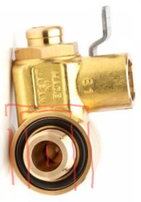

Research done.
instead of F106N & adapter. I will buy new designed, F106SX. Its position can be turn to any direction with the rubber o-ring and washer. Remain shorter and cheaper without the adapter. A hose can be attached to the short nipple. All look good.
https:/www.fumotousa.com/f106sx.html#product-details-tab-s
The oil drain valve is not new to me, I had used 2 Fumoto valves for my previous 2 SUVs a decade ago, then after I got Mityvac oil extractor, I just pumped oil out through the dipstick on all my vehicles even with Fumoto valve.
Now 2022 Glc's M264 engine has NO dipstick, so I am installing a drain valve again.
BTW, I use the plastic ramps to raise the front. Extra stands for additional safety.

Fumoto valve installed and drained with it. Model F106SX. Need to be careful to follow the install instruction. Do Not over tighten the brass bolt.
On ramps, I can drain directly into the jug, which took about 4~5 minutes.
Not even a drop missed.
