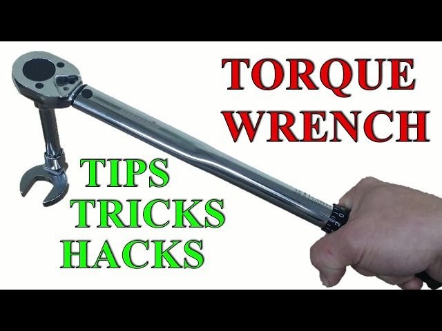

so clean! I am curious how to torque the valve.

Per Fumoto website, the torque value for the valve and the adapter is the same @18 ft lbs. I connected the adapter to the valve at a bench valve (securing the valve body) and joined with a normal torque wrench socket combo. Next, take the assembly over to the oil sump and hand thread on. Switch the socket off the torque wrench to a short extension with a crows foot. preposition the crows foot so that forms 90 degrees to the wrench otherwise your torque values will be wrong. Tighten to 18 ft. lbs. Do not torque to the drain bolt torque of 40Nm/29.5 ft-lb. The material of the adapter is much softer and does not require the higher torque value. I believe the crow's foot is a 7/8" size but you can double check with Fumuto.
The crows foot must be 90 degrees to the wrench to deliver correct torque.
