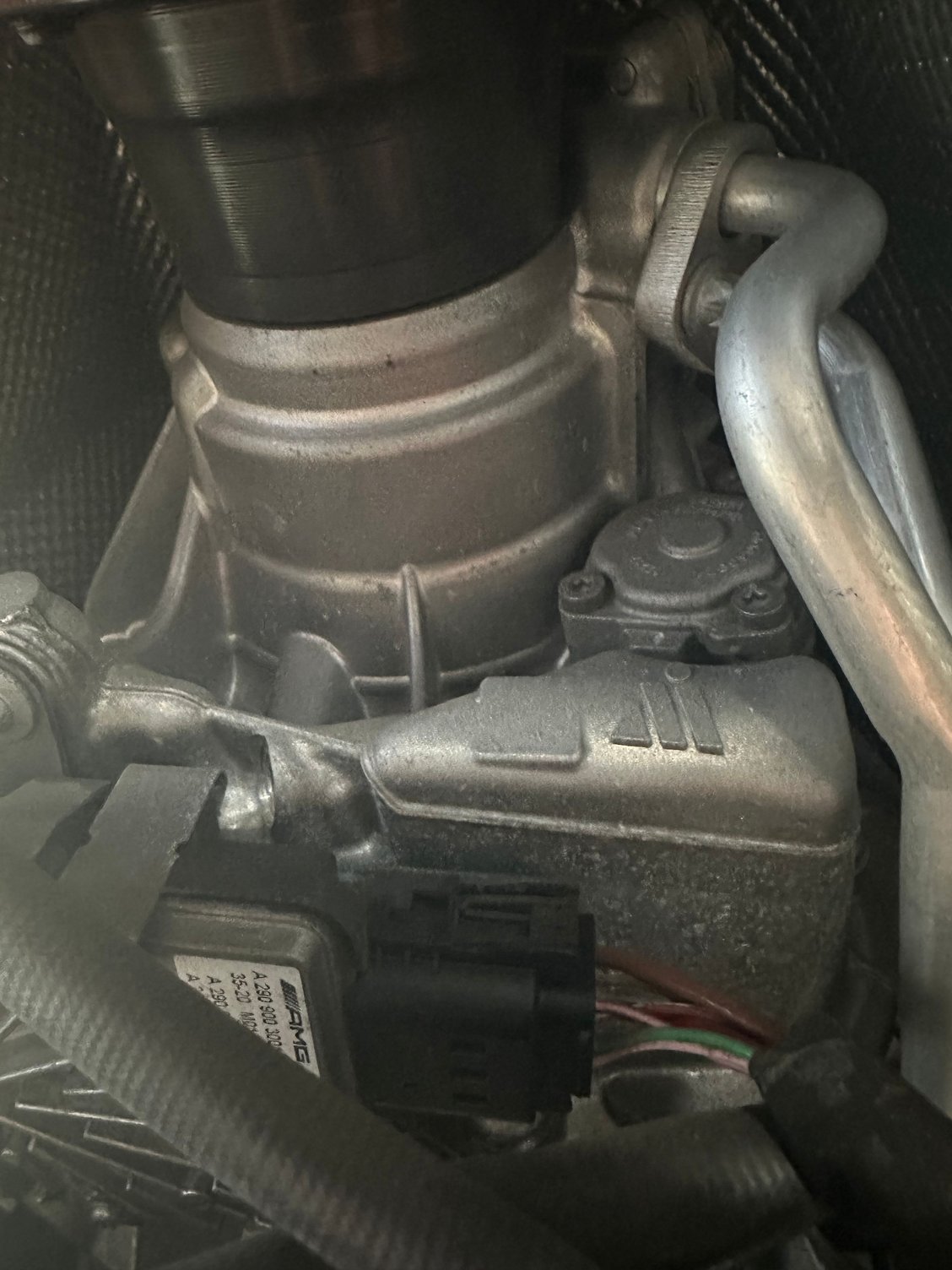

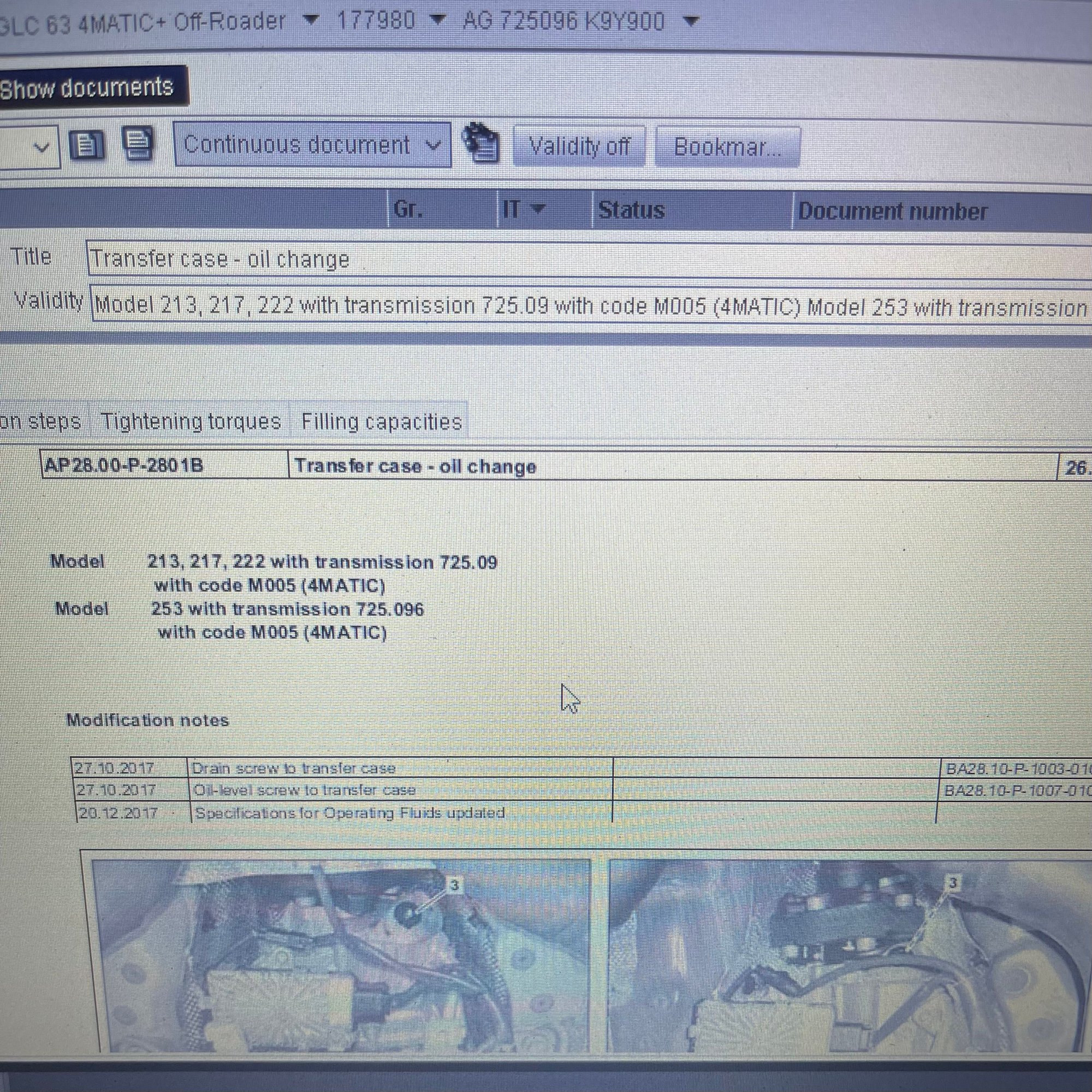

I found some instructions on doing the transfer case and got the trans mount off did the drain part no problem (first picture) then went to fill it and the fill port in this picture (second picture) isn't on my car. Looks completely different in the back of the transfer case. Where do you fill the transfer case from? Last picture is my car, 2020 glc63. Thanks.

The manual youre referencing is effective for the following models
Manual ref
Manual ref

Can you zoom out more in photo? Are you in the right spot?

see attched
File Type: pdf
