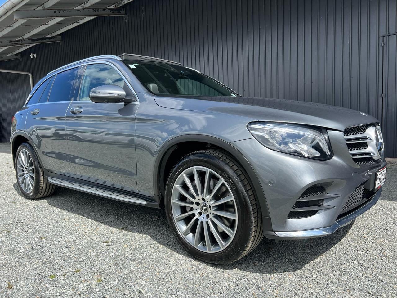

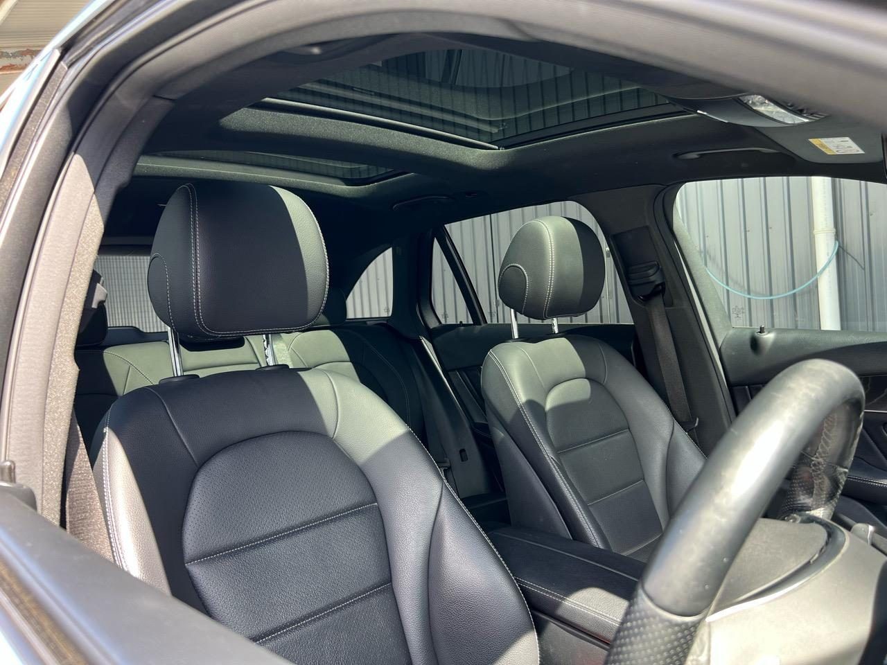

I’m looking at getting a 2018 GLC 250 (AMG Sport Package - 2.0L petrol) with about 33k miles, full service history, and really tidy condition. It's for my wife and she drives around 6–9k miles a year.
Question - is this particular model good for long-term ownership in terms of reliability and running costs, or something to be cautious about?Are there any common issues I should watch out for before purchasing, particularly any upcoming maintenance items given the mileage?
Would really appreciate honest feedback, cheers!
Pics from the dealership:
