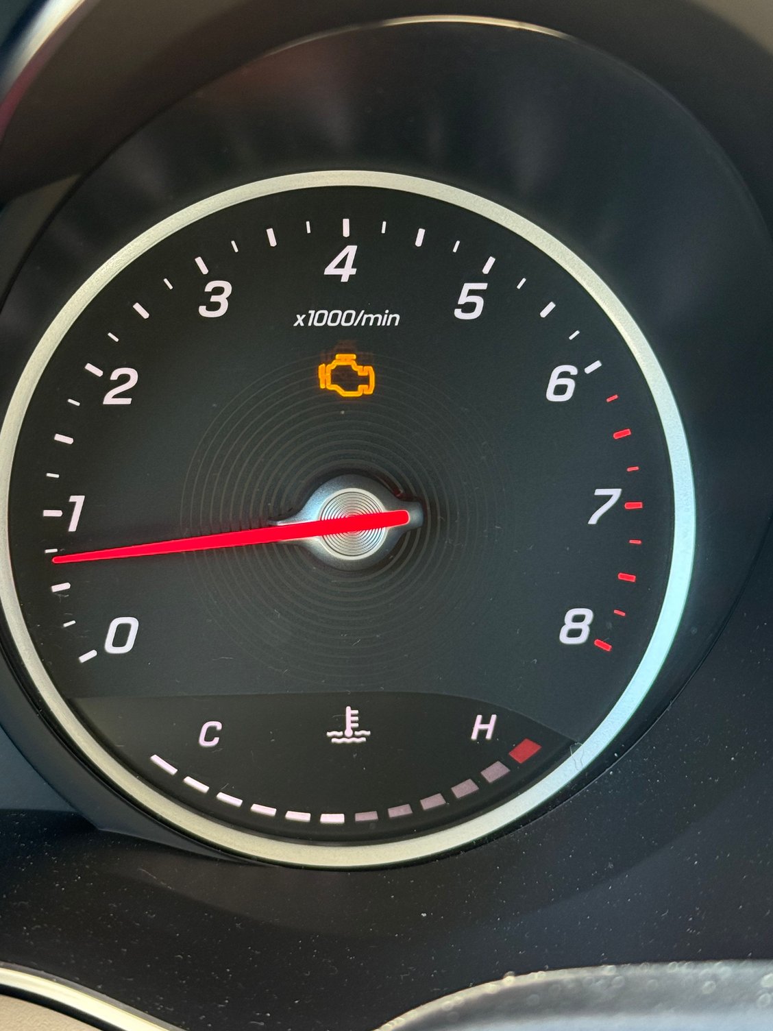

2020 GLC300 4Matic. US model. ~78,889 miles. Purchased new from a Mercedes dealer. Sole owner.
Hey everyone — quick question.
My check engine light just came on out of nowhere. The car was running perfectly fine before this, and I just had routine maintenance done by my independent mechanic. Edit: a new MB battery was replaced. ​​​​​not sure if that matters.
Now the car won’t accelerate properly. It moves, but feels sluggish and kind of jerky, almost like the transmission is hunting or shifting back and forth. I’ve restarted it a couple of times with no change.
I also tried tightening the gas cap and switching between Sport, Eco, and Comfort modes, but nothing made a difference.
Any ideas what this could be?

https://cimg6.ibsrv.net/gimg/www.mbw...bd90174d0.jpeg
At least it is not flashing? If not flashing, you will need a scanner to see what it is it about since CEL can mean so many things. Especially that you are experiencing all those symptoms might not be a good idea to continue driving. Flashing means to not drive at all.
thanks for the important aspect. I did bring the car back home and switched out to another. I’ll take it to the mechanic tomorrow. Thanks!

Fuel rail pressure sensor
My independent mechanic ‘fuel rail pressure sensor’ that was the code, but he sent me back to Mercedes dealership. because he says there is an extended warranty and it has to do with fuel system and he says they’ll probably cover it so that’s where I’m at, but can anybody share more information on fuel rail, pressure sensor? I’m not a mechanic at all.

Dealer repair/resolution: 78902 100 CONNECT BATTERY CHARGER , PERFORMED SDS TEST --CODE---> P019185 The rail pressure sensor has a malfunction. There is a signal above the permissible limit value , PERFORMED SOFTWARE UPDATE FOR M.E CONTROL UNIT AS PER FAULT CODE.
Is this something I could have done, a software update screws up my whole weekend and Monday morning. Good grief! And it was $326, which for me, is not that bad but it’s MB failure, not

OP, I am glad it was super easy fix. To answer your question, this type of software update requires using XENTRY which only those who have it, for example in this case a dealership will be able to perform. Glad it is resolved now.

This happened to me as well a couple of months ago around 72,000 miles - also a 2020 GLC. Software update. Known issue. Has to be done at the dealer.
