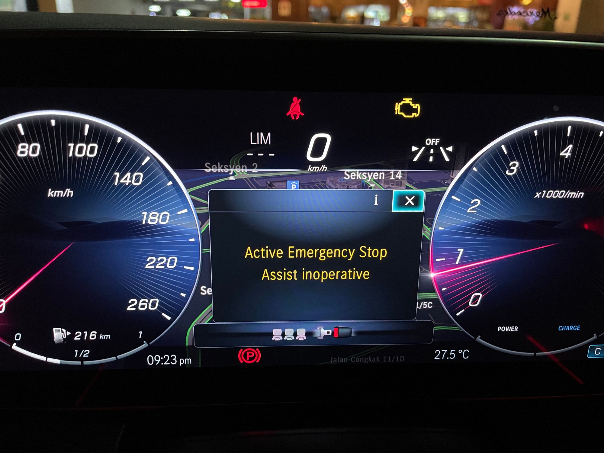

Active emergency stop assist inoperative
My GLC 300 X254 is barely 3 months old. Couple of week after delivery the transmission stuck in D1. Drive home slowly in D1. Let it cool off overnight, it’s okay next morning. Send it back to the dealership, no fault code in the system they said.
in the 2nd month, “active emergency stop assist inoperative” appears on my screen once I start the car. It prevents me from shifting my gear to D or R. The road assist guy advise me to shut it down for 10 minutes and restart. Done that, the car moves but check engine indicator still light up. Send it back to the dealership. After languishing for a few days they coded the start/stop module.
on 25th April it happen again. Can’t drive out from the parking out. Unable to shift to D/R.
After 10 days, it still marooned at the dealership awaiting all clear approval from MB Germany.
