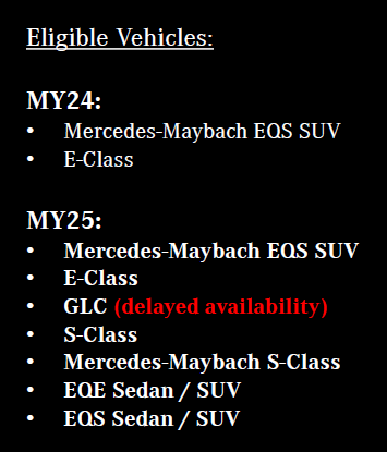

The GLC digital key is listed as "delayed availability" for model year 2025 (as of October 2024). No indication when it will come yet.
Digital Vehicle Key availability is delayed. All cars are equipped with DVK but currently nonfunctional. An OTA update will be available in the coming months to activate this feature.
Do you have an official source for this information? The Digital Extras team via MBUSA Customer Support is adamant that it's not supported on the 2025 GLC 350e. My dealership seems clueless about it. Just trying to cite an official source for the info and perhaps trsck down and availability date.
That second line was copied from the latest order guide from 10/16/2024.
Also, this is from a separate FAQ doc:

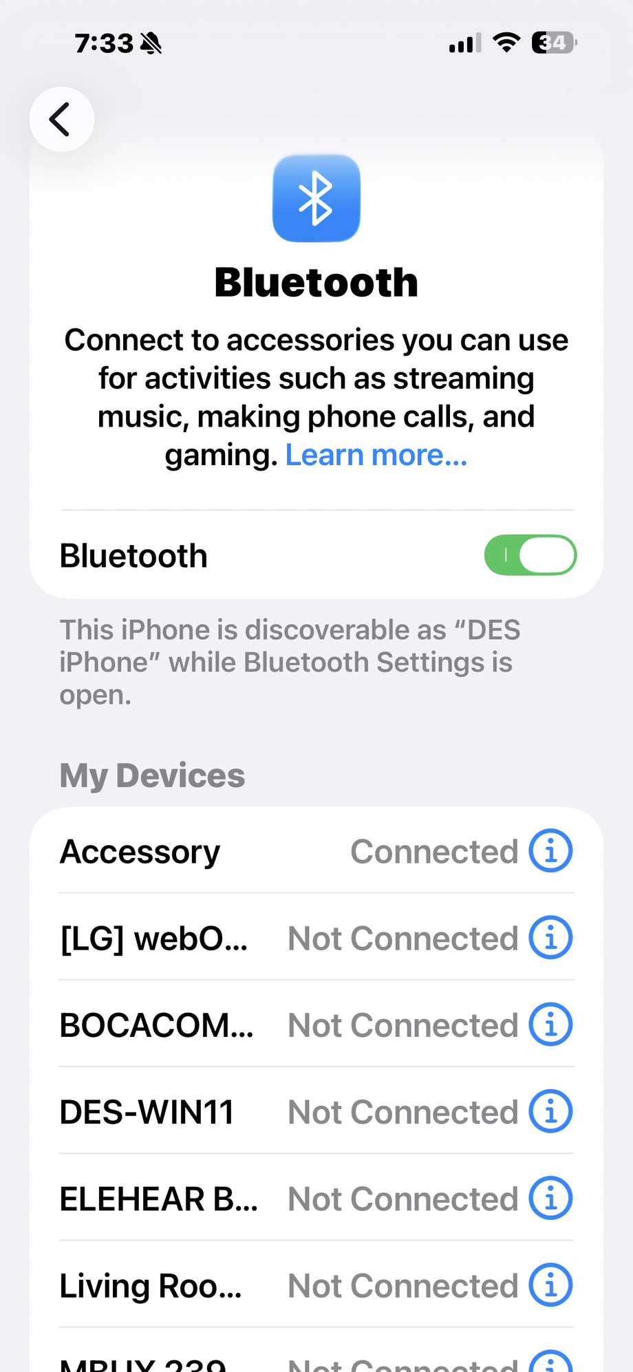

On my new GLC 350e SUV I had no problem setting it and using it. But I had to uninstall because for some reason its Bluetooth connection interfered with my Bluetooth hearing aids. Wouldn’t allow me to connect to the iPhone. It was the only Bluetooth connection that had a problem. Oh well back to keyless entry.

I thought that Digital Vehicle Key uses Ultra Wide Band and NFC, not Bluetooth.
What version of MBUX and mobile app do you have that allowed you to set it up?
Correct, the Digital Key uses UWB, which has nothing to do with Bluetooth. Operates on completely different frequencies and is an entirely different protocol. But could be a software glitch on the iOS side related to the BT hearing aids. Which iPhone and iOS version did this happen with?

Ok guy’s But there is something connecting to Bluetooth and interfering with my particular hearing aids only when I want to use the hearing aid with a phone call. It doesn’t interfere with streaming music!
My MBUX is version E333.7.1-56, Me app is 3.60.0 US using iPhone 15 pro max. Accessory is automatically connected by the software and shows up in my Bluetooth along with the key that is added to my wallet. You can’t “forget “ accessory inside Bluetooth you have to delete from Mercedes me in the setup. Any ideas as to why? Like I said back to keyless entry which works.
4

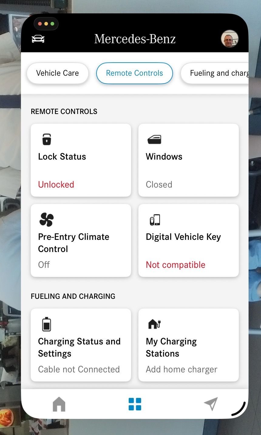

I have the same Mercedes Me app version and I don't have the Digital Vehicle Key option in the app. MBUX version in my GLC 350e appears to be newer than yours - E333.8-58, MBUX does have an option to start setting up Digital Vehicle Key, but it always fails. The only thing I can think of is that they did not enable something in our vehicle configuration on the Mercedes service side and the Digital Vehicle Key option does not show up in the Mercedes Me app.

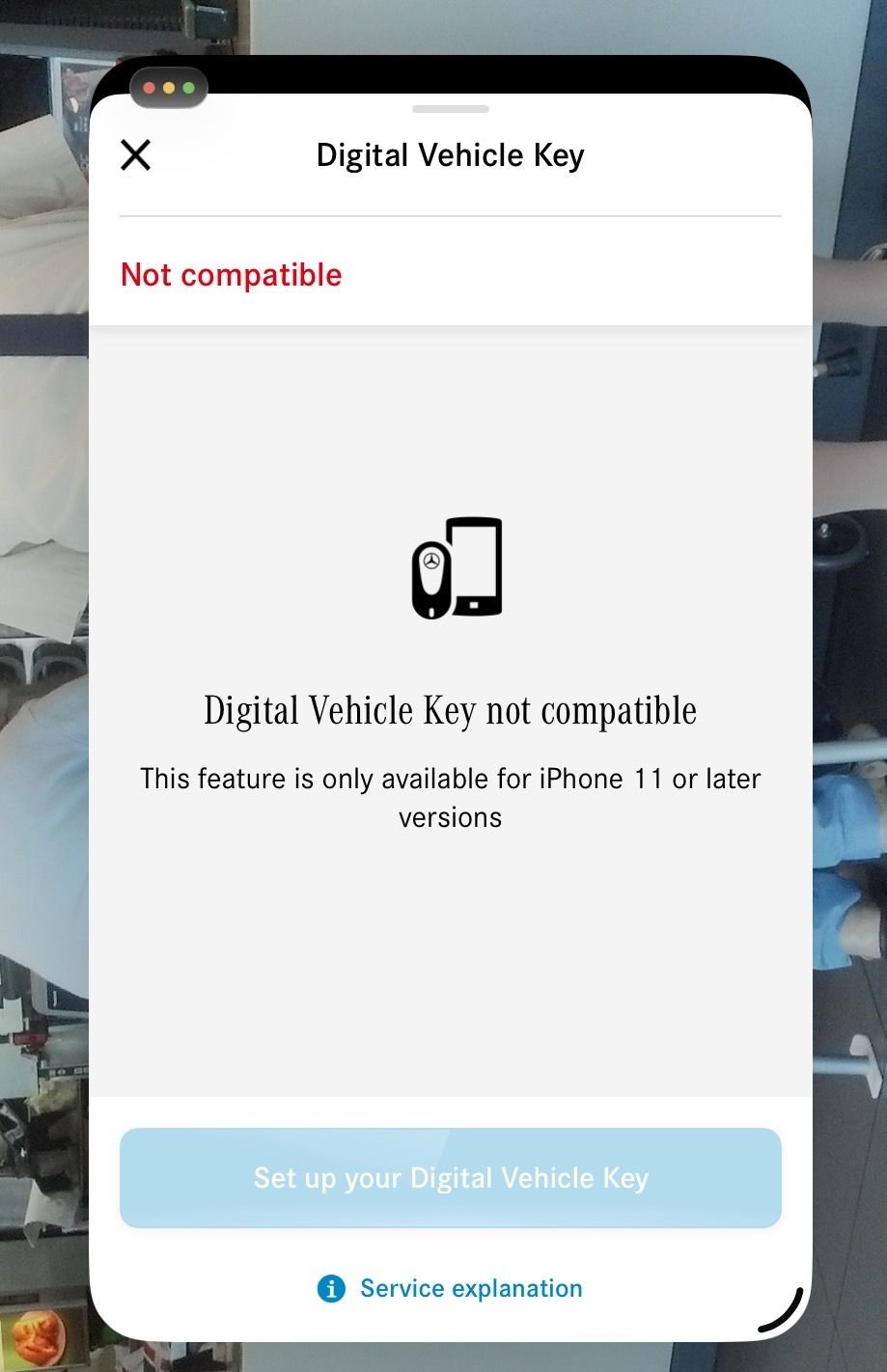

The 2 photos that say Not Compatible are from my iPad. The Active photo is from my iPhone. Both iPhone & iPad Mercedes Me apps are v3.60.0. I guess we both need a trip to dealer and may get some answers. But chances are they won’t know and point you to another source…

I see you have MY26 (254X), I have MY25 254X, so I wonder if what the Mercedes representative told me on the phone is true - they are still working on enabling it on MY25, but MY26 already has it enabled.

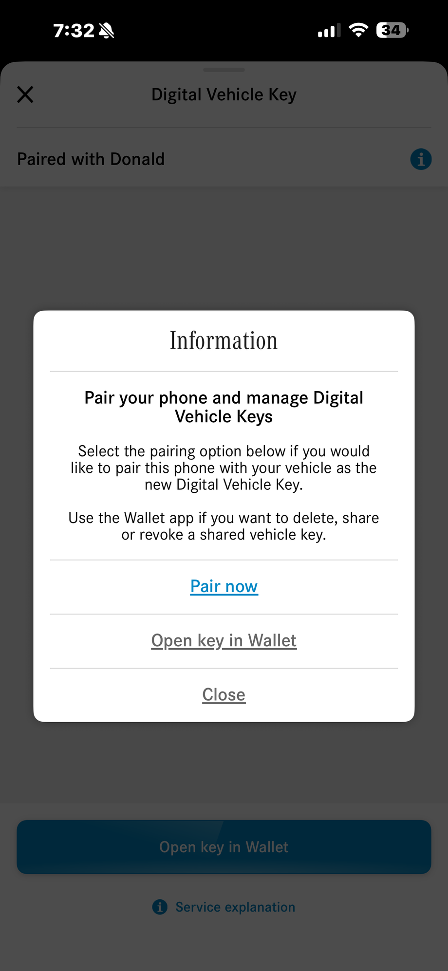

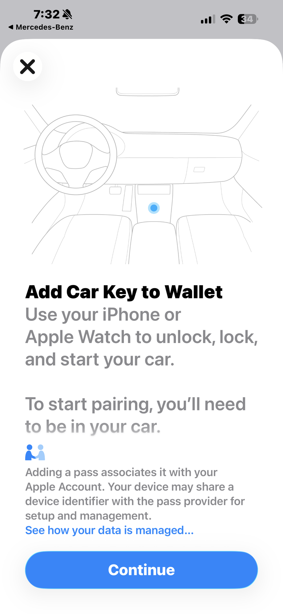

This may be old news, but I just purchased a 2026 GLC300, and did indeed get digital key to work, both on my phone and my Apple Watch. It took a while to get it activated, I finally solved it by going to the Mercedes-Benz app, then clicking on the little portrait in the upper left corner, then clicking on the larger portrait at the top of the screen, then scrolling to the bottom and completing the "identity check" item. It prompts you to take a photo of your photo ID and a selfie. A few minutes later the task completes.

I believe so, it just mysteriously wouldn't activate until I found the hidden identity check section.
It was in the "MBUX Comfort" category in "Digital Extras"
