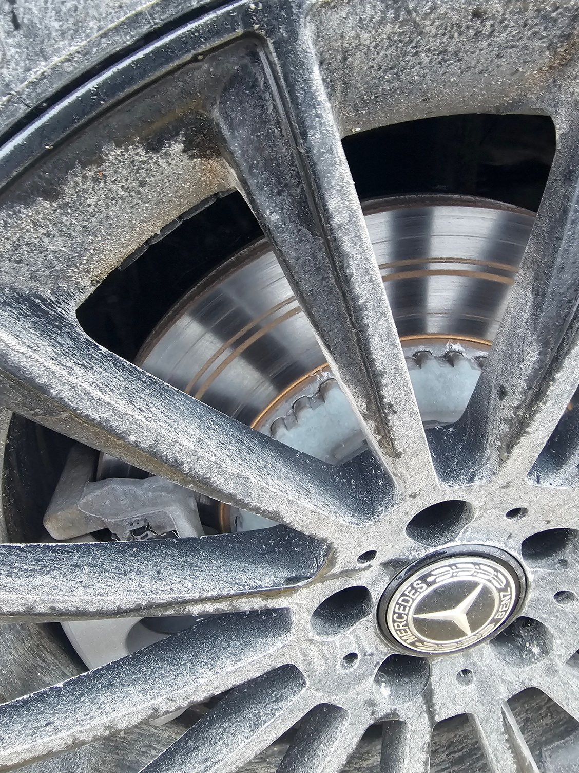

I drove about 500km yesterday in very slushy/wet snow. Today I noticed my left rear rotor has 2 thin bands of rust that will no go away. Should I be having the dealership take a look or will this eventually resolve on its own? I tried pressure washing the caliper/break pad thinking that there might be a couple small pebbles that are stuck. Unfortunately, this did not improve anything. I have attached images below for reference.
Rear Left: note the two thin bands of rust

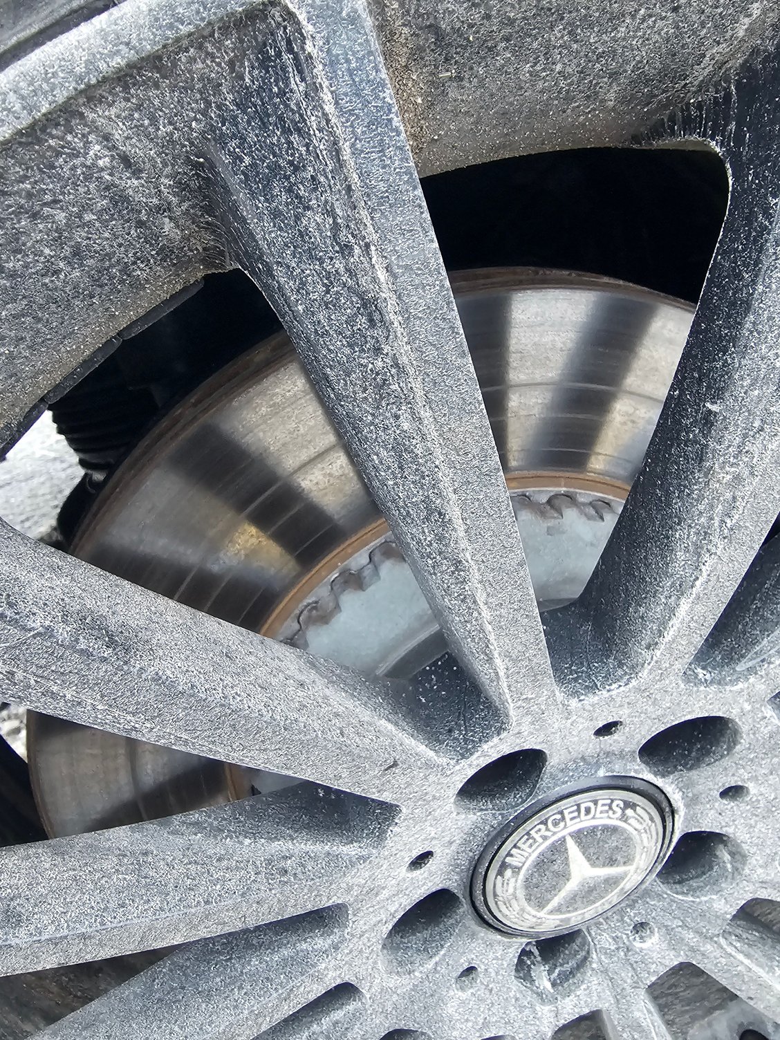

Rear right: no thin bands of rust

Worth asking about - likely the pad is for whatever reason lacking a bit of material in that area. Both rotors show a similar process at work. The caliper holders may be jamming a little, perhaps need a de-rusting and lube.

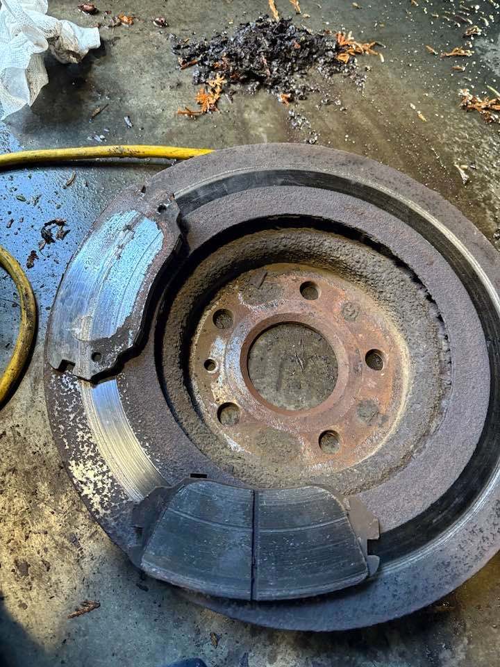

You want to see REALLY bad rust rings?
My son-in-law's Equinox V6. Front rotors! The caliper holder was so corroded that the pads could not move properly and it wore the inner pad out prematurely. Our cleaning the rust off and a light lube made the replacements work like new.

The pads should be removed and inspected to find the source of the problem. Best case, a foreign object is found and can be removed and you'll be back in business. Pads are completely capable of rubbing away mild rust. If the pads are damaged on the other hand they will need to be replaced. The dealer may jump at the chance to tell you all the pads and rotors on the car should be replaced, I advise some skepticism. You might get a second opinion from an independent Mercedes mechanic.

go try to re-bed the brakes. This did not just happen but became evident with salt. You could remove the pads to look for a You could remove the pads to look for a pebble first because the pressure washer is not gonna get that out. Otherwise, new pads, and rotors with a proper bedding in.

My guess, a couple of pebbles were dragged across the brake pad forming grooves in the pad which now does not contact the disc and without that contact rust rings formed. Not a manufacturing defect and so not a warranty situation. Probably will work its way out as pad wears down. I would not spend a penny on this. My two cents.

those rust rings are just road salt and grime preventing the pads from scrubbing the rotor surface find a safe road and do 5 firm stops from 60kmh to 10kmh to burn them off only go to the dealer if you hear metal scraping or feel the pedal pulsating

We're all just speculating here - the pad needs to be removed to figure out what is really going on.
