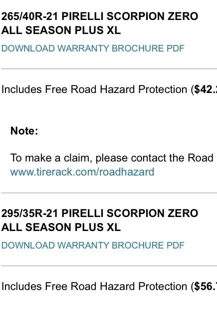

I have a set of OEM 20” and OEM 21” with summer tires. It’s been in the 50’s and thankfully I’ve had no crabbing. Definitely an issue, not universal as is the case with the Porsche from what I’ve seen.

this is most definitely not an education issue. most of us have had performance vehicles from other manufactures. my crabbing happens even when i am not full tilt. i do not cpmplain about it much because it never happens on my 22" wheels which I commute in. mind you the 22" wheels still have 265 width tire in Conti DWS06.
I just ordered another set of wheels and i'll run 20" Michelins on them. I suspect the issue would be absent on those.

I bought the car last February, I heard the noise every time I pulled out of the garage. I complained to the Dealer in Windsor Ontario. They said the tires all seasons. They did not give me an solution to the problem. I have It is really bad on wet and cold conditions. Any suggestions 21 conti
conti
I had the same issue with my 2019 GLC 43 with 21 inch Contis every time I pulled out of driveway in reverse. Got worse when the wet and cold season started. I replaced them with Pirelli Scorpion Zero All Season tires and haven’t had the issue since. They are not exactly the same size, but I haven’t noticed any issues, though YMMV. Bought them from Tire Rack:
