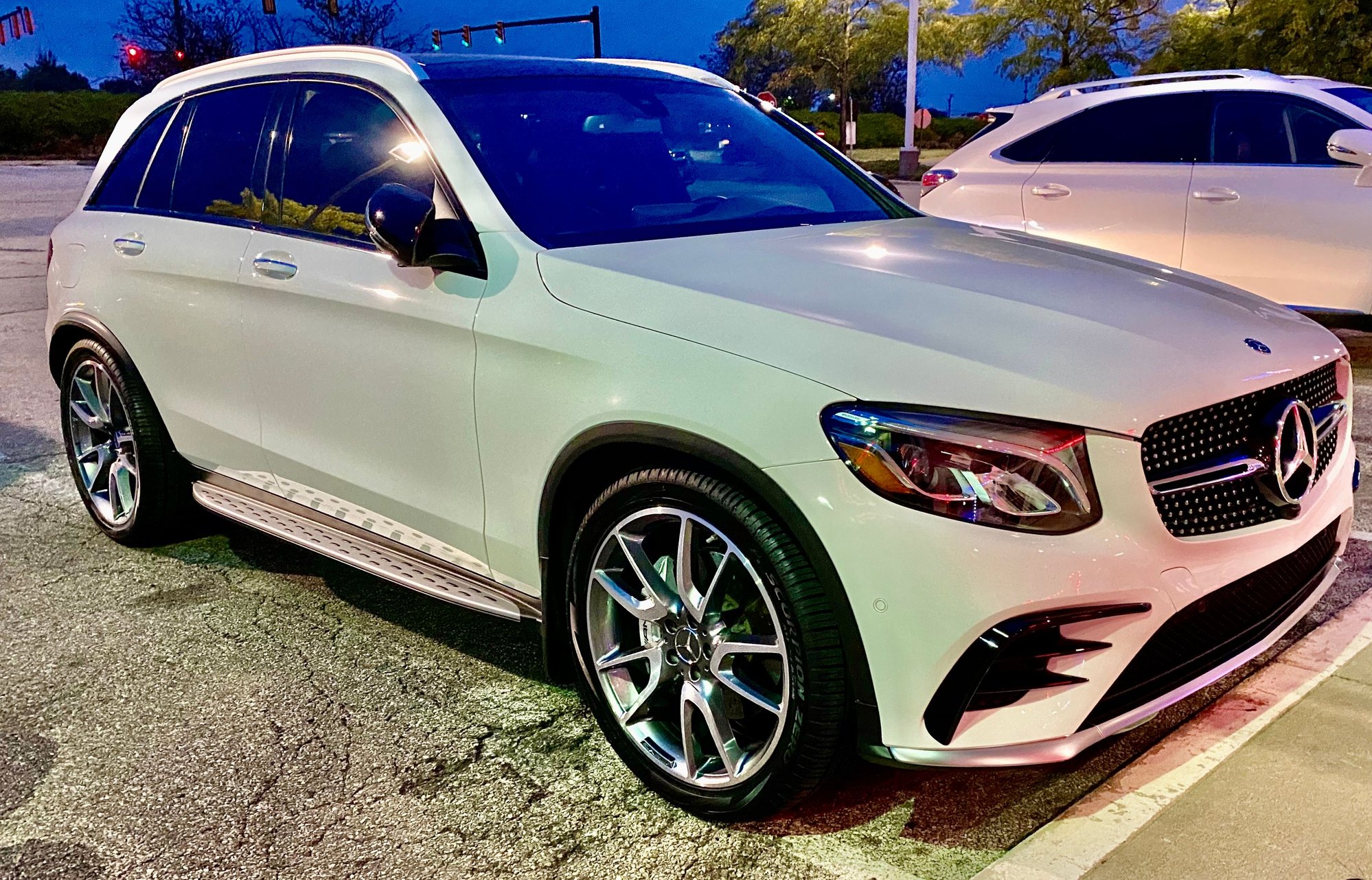

What type of tire did you get please!!!🙏🏻 Help me with this!!!!! I didn’t knew anything about the issue!! And I’m reading and you seem like to be the first to end the issue buying a new set of tires!!! Help us please 🙏🏻
Old Nov 23, 2024 | 09:59 PM
  #112
andrew e coupe's Avatar
Joined: May 2012
Posts: 781
Likes: 72
From: Ohio
2017 E400 Coupe & 2018 GLC43

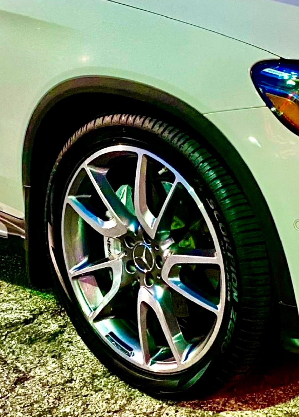

~ Yes these are the Pirelli Scorpion Zero All Season Tires. Fronts 265/40/21 and Rears are 295/35/21.
Truly an amazing tire and no crapping at all.
Old Nov 24, 2024 | 02:45 AM
  #113
Petronas1's Avatar
Joined: Nov 2024
From: New Jersey
2021 GLC 43 SUV
Originally Posted by andrew e coupe
~ I have added all season tires and the issue is completely gone. No longer... a concern thankfully.
Mine is a 2018 with the optional 21” wheels.
Thank you 🙏🏻!!! I just got the 43 is a 2021 I almost bought the new 2024 but the power unit being a I4 engine was complete let down so I went for the V6!!! But I had no idea the this was going to happen to a Mercedes Benz and a AMG!!! I thought the car was a POS!!! This makes me feel better cause I love the car I had a 2018 GLC300 AMG package but I wanted and I need it an upgrade!!! And again….. thank you 🙏🏻 blessings I’ll be getting a set of Pirelli’s to make my and ours GLC 43’s perfect!! 👍🏻
