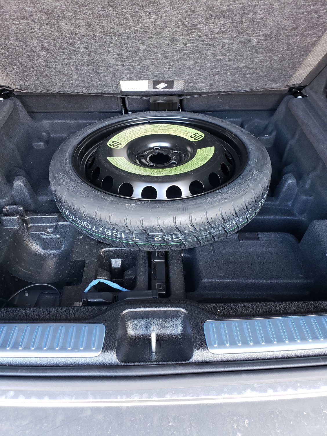

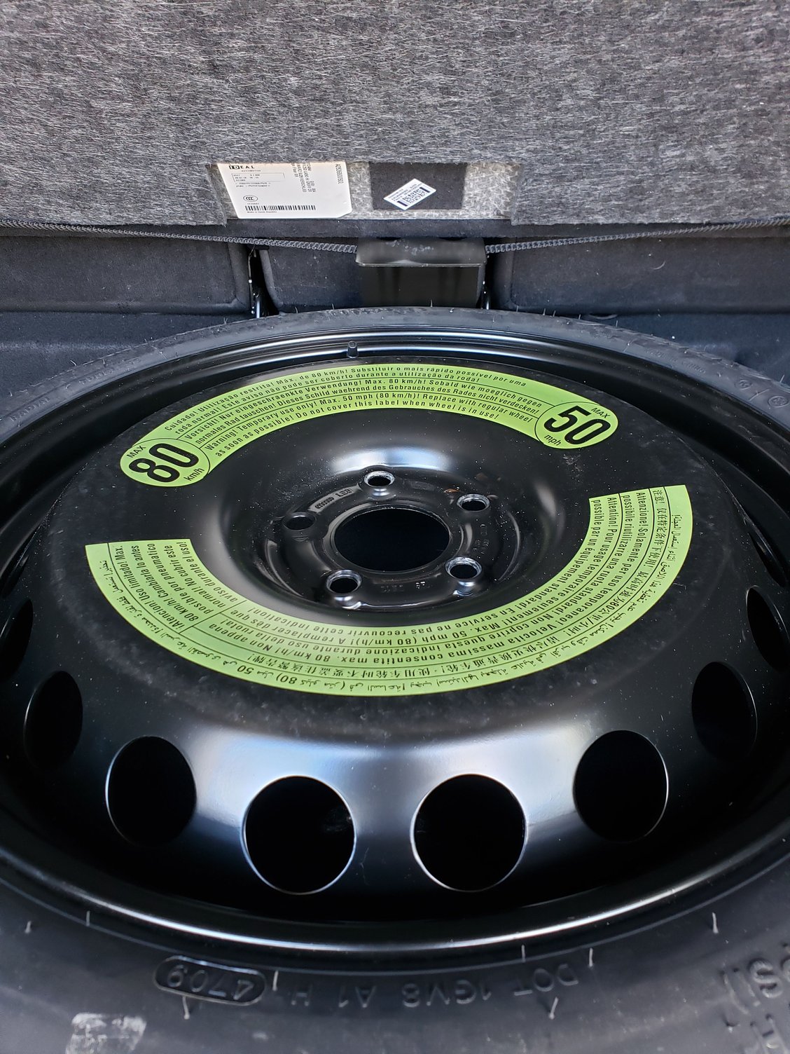

I did some research last month after getting a nail in one of my rear tire .
I was driving on highway 5 in the middle of nowhere when I stopped for gas and saw a nail in the middle inside the tire tread .I was not losing air .
Kept going for another 300+ miles and stop to a tire shop . The guy remove the nail , by chance ,the tire was not punctured but made me think of getting a spare when I go for long trip .
I found that we only can go with a 19 inch spare , 18 inch won't free caliper .
A friend of mine as a GLS 63 AMG who has a spare 19 X 41/2 ET 40 for the rim and 155 X 80 X 19 for the tire
Those spare are in GL GLE GLS 550 and the older ML
I am confident they will fit the 43
I also played little bit with the spare from my Audi S4 19 inch spare 19 X 4 ET 22 for the rim and 125 X 70 X 19 for the tire
Tire from the Audi fit in the trunk space
Now I have to borrow my friend spare and see if it fit
Here is picks of the S4 spare in the trunk space
I didn't try if the S4 spare fit the GLC , maybe !

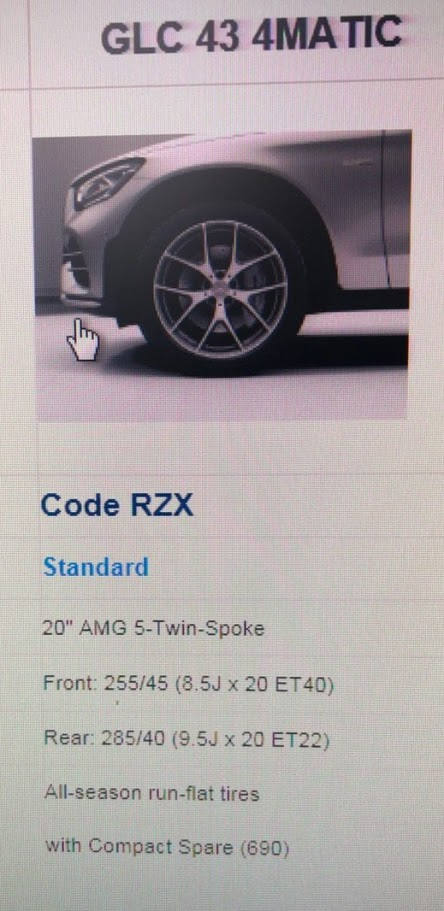

In the 2020 USA ordering guide page 51 it shows the standard wheels with R02: all season tires R66: MOE Tires (Extended Mobility) but doesn't show run flats and spare compact tire as in the Canadian ordering guide. Have they changed it for the USA ordering guide?
Rick
Old Nov 9, 2019 | 04:01 PM
MercOne1's Avatar
Joined: May 2019
Posts: 283
Likes: 108
2020 GLC43 | 2020 GLE350 | 2014 E350 (sold)
Rick
The DOG is the same as that of 9/5 edition. The DOG doesnt define R02 or R66. Could that refer to summer vs. all season tires? That was the only option I had on tires when ordering my 2020 GLC43 with standard RZX wheels. There was no option to order non run flat tires.
Old Nov 9, 2019 | 04:26 PM
RickSo's Avatar
Joined: Oct 2019
Posts: 53
Likes: 8
From: Alberta, Canada
2020 GLC43 Coupe / 2017 Smart Brabus
Hi MercOne1,
In the picture above under RZX it defines R02, R66 below the 20" AMG Y 5-Spoke and the description of those codes is in the black footer bottom of the page. My understanding is that the MOE Tires Extend Mobility is a run flat tire. Just no compact spare tire (690) listed as in the Canadian ordering guide picture. We pay tire tax here in Alberta and when we wrote up the order I paid $4.00 per tire for 5 tires ($20.00) on the invoice.
Rick
Old Nov 9, 2019 | 04:33 PM
MercOne1's Avatar
Joined: May 2019
Posts: 283
Likes: 108
Hi MercOne1,
Rick
thanks for pointing out those definitions in the footer that I didn’t see.
yes, MOE is run flat. I guess you’re right that only the rzx has run flat tires, the others get non run flat with tire sealant?
also, the spare tire is listed on page 63 of the US DOG as a stand-alone option of $200.
