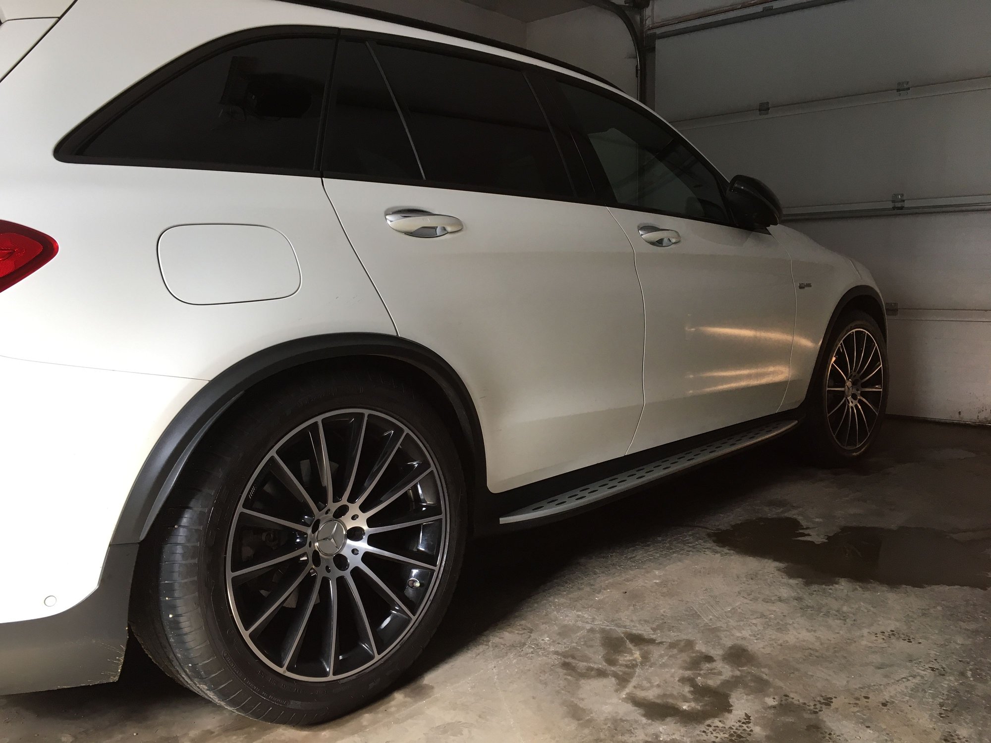

For reference, here is a picture of it in "sag mode". Thanks for any advice of feedback anyone has.

Had it in for a look and they found a leak in one of the rear bags so that will be replaced under warranty. Didn't have the part and will take a couple weeks to get it in but glad it is under warranty. I hope this isn't a common issue and that I need to worry about the other side having the same issue in the near future. Car currently has just under 80,000km so getting in just under the wire for warranty coverage.

Just another update to close the loop on this. Got the car back after the replacement of rear suspension air bag and noticed that it was still sagging after sitting. Took it back in and they found the air bag on the other rear corner was leaking. Not sure if this is just coincidence and back luck for me, if there is something about the way this car was driven, the conditions where I live, or if this is a potential issue for all of us to look forward to.

I wasn't aware that the non-AMG models came with or could be optioned with air suspension. Regardless, they did say that they found a leak in both sides at the rear and while I'd agree that it would be quite the coincidence for both to go at the same time, after they replaced the second side, it hasn't sagged at all. Good to know about levelling sensors though as that certainly has some logic behind it.
