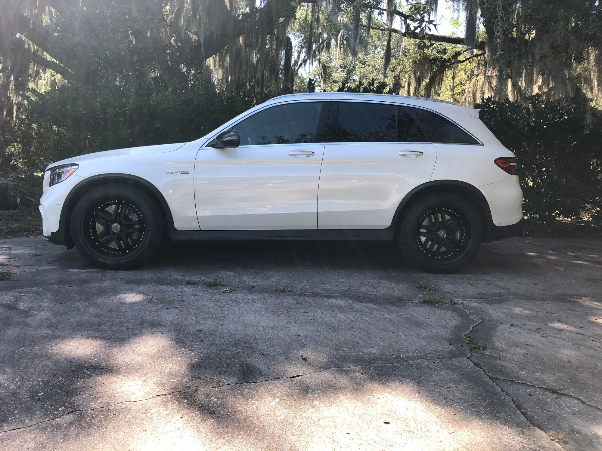

This one wasn't easy; I had to test fit the mounted wheels and tires to see if I could even make it work....and it does!
Milanni Kapri wheels 20X10.5, +30 offset (had to use 3mm hubcentric spacers on the front wheels).
Cooper Zeon LTZ tires (275/45R20)
Slightly more road noise, but handles great.
