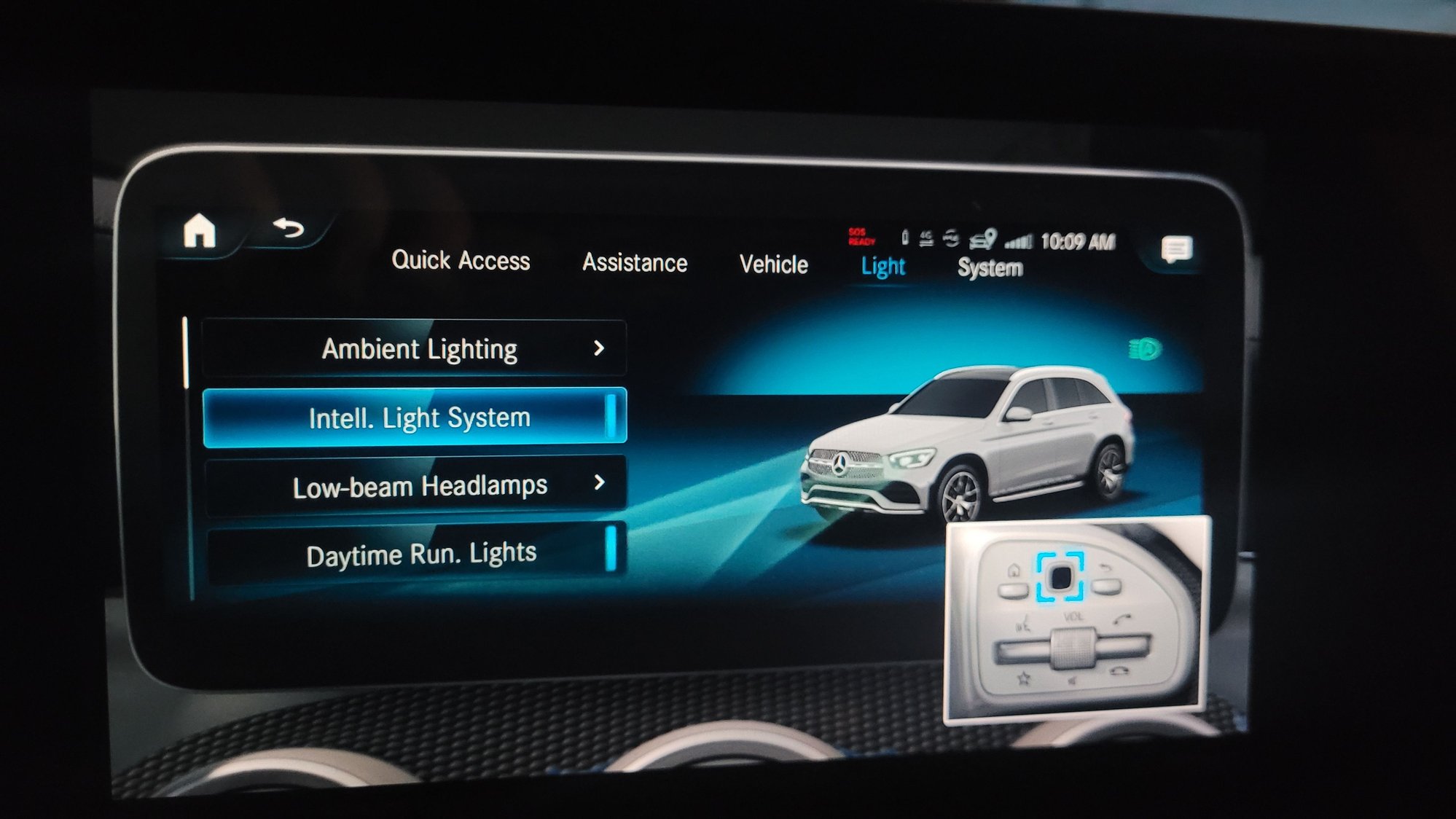

Multibeam is option code 640 on your build sheet (vin look up on Datamb,com or lastvin.com) 640 DYNAMIC LED HEADLAMPS, SAE, RIGHT-HAND TRAFFIC.
Another way to check is the large "eye' main lamp is located inboard and the housing say "Multibeam" along the chrome bottom edge of the housing. On the standard non-multibeam the larger lamp is outboard.
The thread "Multibeam in Canada" has descriptions and reports that apply to both US and Canada cars. Consensus is it works perfectly. If you drive on totally dark roads at night is probably worth having.

640 and 608 option codes qualifies your car to be changed to the European firmware,
The "something" is explained is the previous ~10-15 posts of this thread.

Note that Mercedes charges much more in EU for Multibeam than in US/Canada, surely a perceived value ploy. We are getting the same hardware with crippled firmware for less money. Making hay while the sun shines is a possible explanation for the pricing, but probably not quite the whole story.
Another view would be this remote installer must address the VIN to splice the code and in a couple cases have been very responsive to any user problems. Splicing wholesale pieces of firmware code needed to make this work is different than say, turning on CarPlay/Android. In this later case is around a $100 fee. No firmware is modified. Two bits are changed from 0 to 1 to allow these features and works in all cases.
In some chassis series, Multibeam firmware is over two hundred separate blocks of code that has to be stripped and replaced and there are small, but critical variations between chassis series that must be observed. I think MB engineering is moving to unify their coding so that options are physically installed and flags simply set in identical firmware loads, just like using the same door handles and rearview mirrors everywhere, but this is a project still underway. For that matter such unification projects are in hand in every manufacturer's engineering development programs. Alas, a separate topic.

Reviving an old thread, my GLC43's build date is late 2020 (Q3 or Q4) and has the LED intelligent light system. Since the law changed in 2019 and it's now "legal" I am trying to figure out if my car is coded for it from the factory? The headlights do the little dance upon start up at night and when driving on a somewhat dim road the high beams turn on as a curtain and makes the little black box for incoming cars or parked cars. It also dims off when I'm back under a well lit road. I also get corner illumination when the turn signal is activated and the headlight beams' swivel to the direction of me turning at low speeds.
Thanks,

Yep, you've got the capability for the intelligent multibeam lights, you just need the coding done to unlock it. Send Vlad your VIN and he'll be able to do it for you.

That I understand but what I was trying to see is if the car already came with the coding unlocked based on the features I described that are already present and working.

It's a bit unclear. All of the things you see your lights doing are not indicative of the multibeam functionality, except for the black cutout for oncoming cars (and ones in front of you). If your high beams are on and cars coming toward you aren't flashing their brights at you, then you likely have multibeam. I've also noticed that brightly lit reflective street signs will suddenly dim, which I believe the car does when it notices them.
It's just odd though, because my 2020 43 didn't come with them activated. Maybe they did for later in the model year, I dunno. You could always look up your VIN and see if multibeam is listed.

Couple of questions for you...
1) Does your MBUX have the additional Light menus (Intell. Light System & Low-beam Headlamps) now?
2) Was your issue after initial coding, the high beams not automatically switching even though the icon is shown in the instrument cluster?
Thank you, just trying to figure this out for my vehicle.
1) I don’t think so? I looked in the Settings menu but didn’t see anything. I may not have looked in the right place. All I know is if I leave the headlights in Auto the multi-beam turns on when the brights go on.
2) No. The lights always switched between normal and bright, but the brights didn’t have the intelligent multi-beam enabled until after I had Vlad do it for me.
Thank you!
I'm doing this on my own and wasn't sure if the menu was required. They show it displayed in the 'operator's menu' animation (video). Glad that's not actually needed!
My lights now do active stuff on low, but my auto high-beam no longer switches on the 'brights' like it did before the VeDoc change (-608 +628) and SCN coding.
Here's a poor picture of the video playing in my mbux display (I assume it's there for other regions)
Picture of video playing in mbux, not my actual menu
I'd say something is off. The lights not going to bright when they're on Auto isn't normal. (I assume you've tested in a very dark spot where they should truly turn on.) Mine work completely the same as they did when I bought the car, except now when they go to brights (blue icon on the dash), the multi-beam is activated (there's no icon saying so, you can just see it working). Also, I don't have that menu you screengrabbed. You may need to reset things, if possible. Oh, and I don't know what VeDoc and SCN coding is - I'm not a car guy. I just know that I plugged in the OBDII plug from Vlad, did the flash or whatever, and I had multi-beams.
