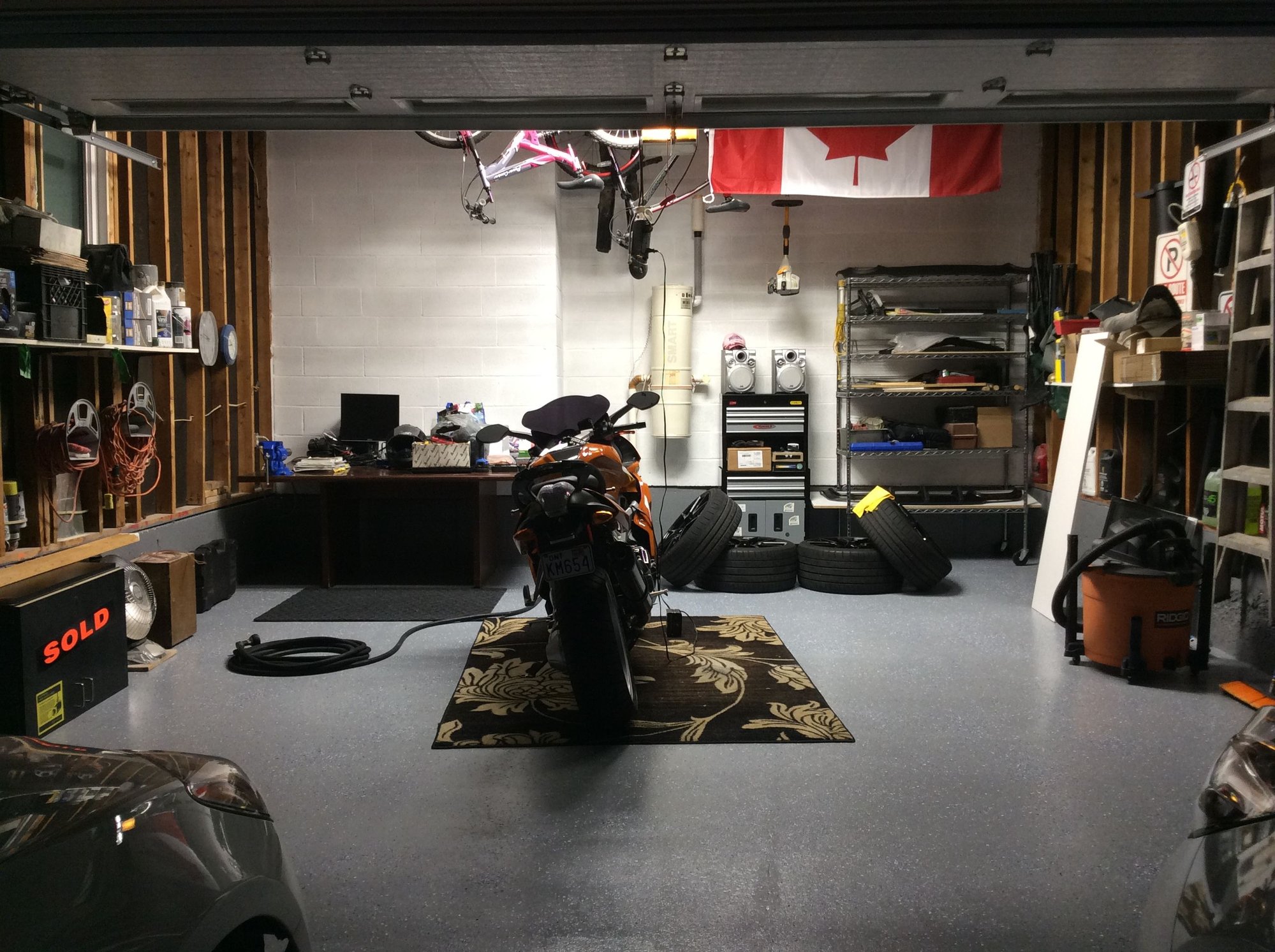

Nope, this is what garages are for....lol

Weedeaters, pink bikes and vacuums?
