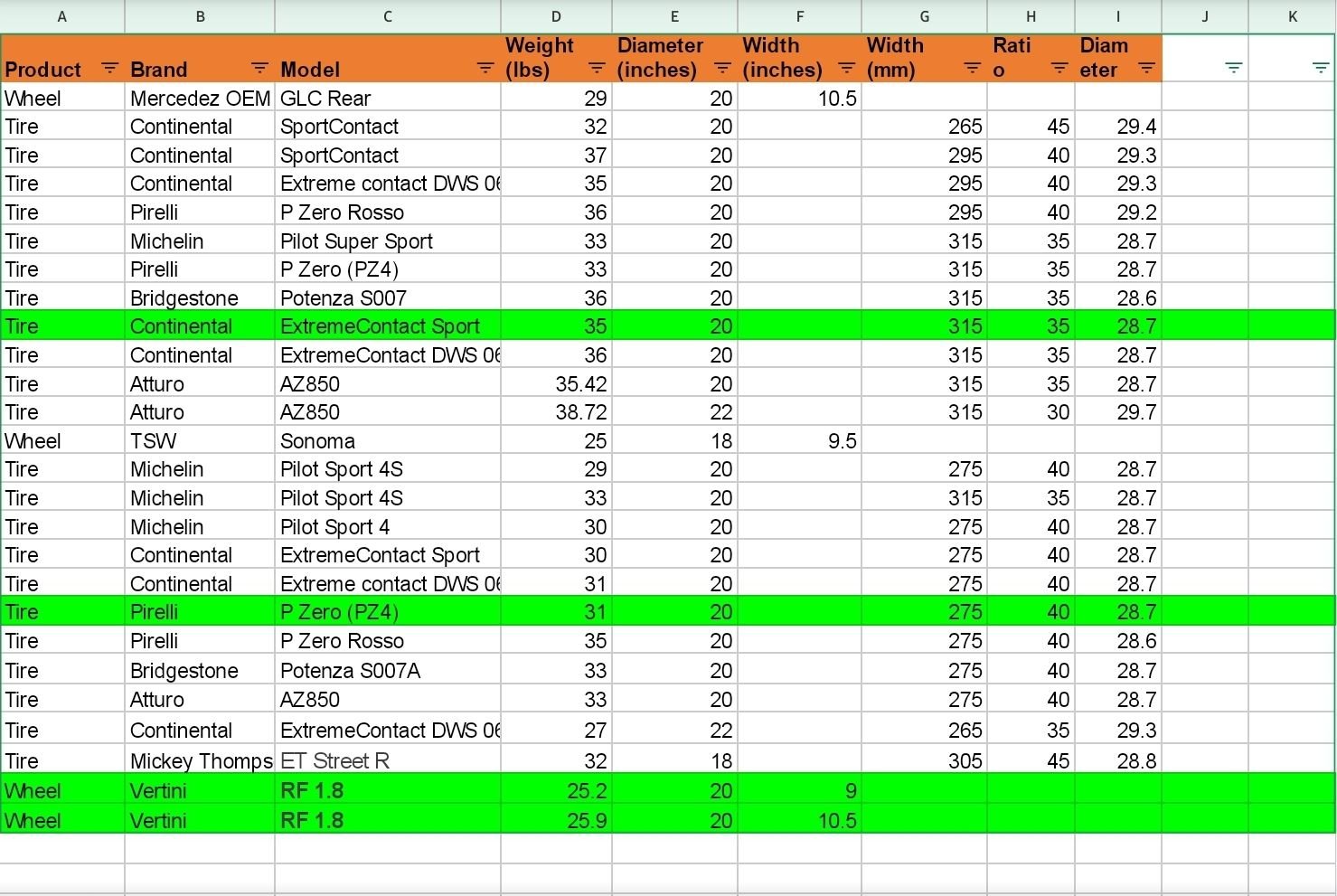

I have dropoed a phenomenal 😔 30lbs of "unsprung weight" by going to lighter wheels and tires. my Vertini wheels weigh about 26lbs in 9" and 10.5" sizes. Tge Michelins weigh 33lbs in 315/35R20 for the rear and 29kbs in 275/40r20 up front versus 37lb rear 32lb front stock Continental tires. Note that these sizes are 0.6" shorter than stock, so i may be losing some performance numbers there.
