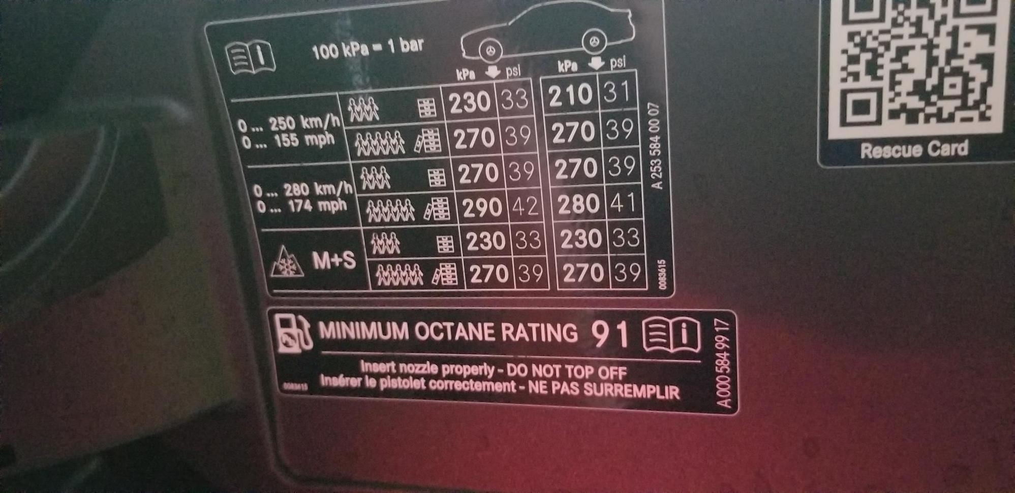

Here is my gas filler door sticker.

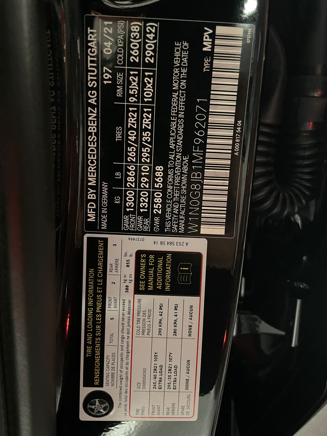

My 63 SUV has 42s up front and 39s in the back, from dealer.
Not sure why i have 2 sets of stickers with different recommended tire pressures.

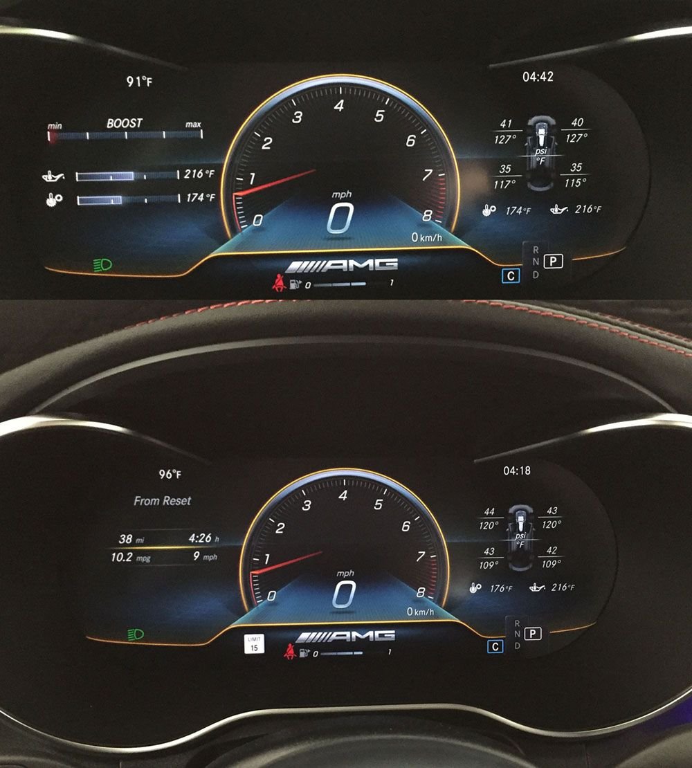

I run 40 psi cold on all 4 tires, stock was at 36F 31R and I noticed that tire temps are a lot lower with higher psi.
@Ftpohyeah
Do you have a sticker on the inside of the fuel filler lid? It looks like the sticker with the 42/41 is for when the vehicle is heavily loaded and the 38/42 for normal load to me. Probably best to confirm with the dealer, but in my experience the dealer typically puts extra air and I think it's to avoid a low air pressure warning message between visits.

@Regis I have the exact same sticker as @tedboss1 first car ive owned with 3 different tire pressure stickers. also, front 33 with rear 31 seems low to me.
Me, my wife and my 2 yo are just about 400 lbs so maybe ill do 35/35 but the ride is pretty good with 40/37 altho the bumps are intense.

@Ftpohyeah
I use the sticker on the fuel filler door, and I think for normal load is 32/32 and heavy 35/38 if I remember correctly. I run mine at the normal load as I find the heavy load pressures to be a bit harsh for my everyday driving.
