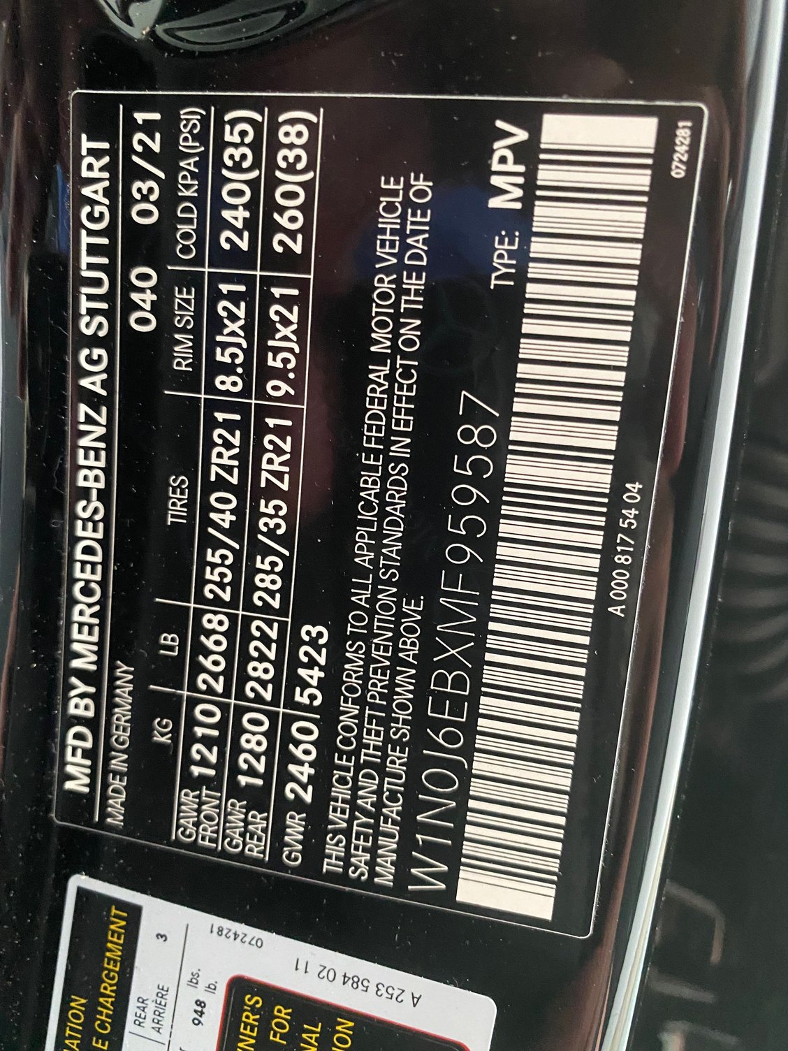

Mystery: The tire pressure decal on my door pilar, indicates 8.5” front rims and 9.5” rear rims per my 21” tires. VIN specs indicate 8.5” f/r. How can I find my rear rim size w/o removing wheel?

The black sticker with the VIN should be the correct info. the specs also matches the 2021 order guide.

There is no mention of 9.5" rear rim on invoice or VIN lookup; nor is there any mention of staggered wheels. Do 8.5 f, 9.5 r rims come standard with staggered wheels?

For GLC43 with the 21” wheel option, the rims/tires are a staggered setup - 8.5” front and 9.5” rear. You will also see that the tire sizes are different front to rear.
