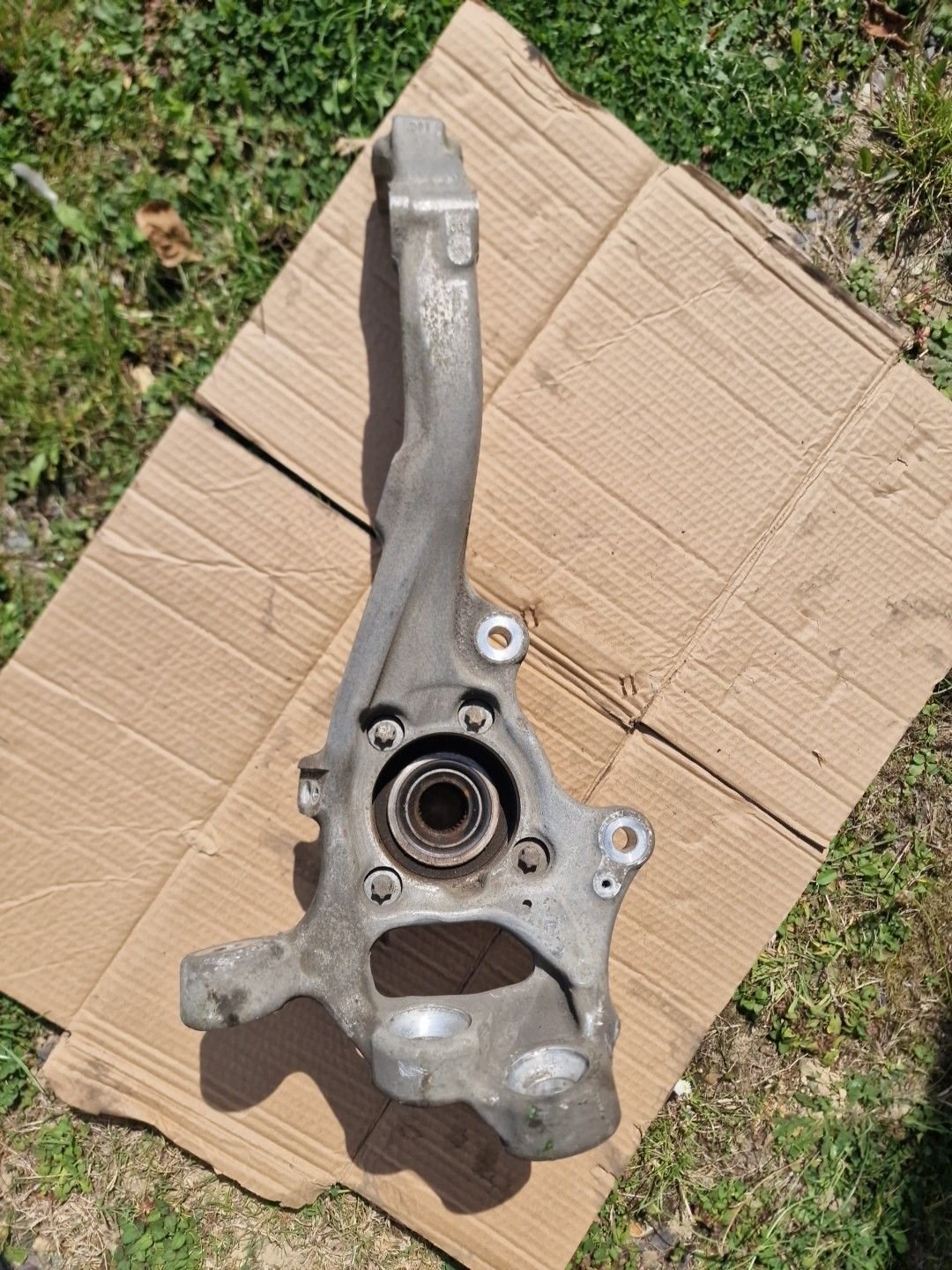

After 2018 MB redesign the steering knuckles and crabbing problems gone I heard. They was replacing by the warranty at first than stop it. If you have 21" setup any tyres make won't help. I run fresh Conty and crabbing still there.

2021 GLC 43 Coupe Crabbing Issue Resolved
I’m not sure if Mercedes did any redesign on the knuckles on my particular model, but Fletcher Jones Mercedes mentioned to me that it was a known issue, but would not be covered under warranty. I have 21” wheels. The stock Conti summer tires crabbed at any temperature below 70°F. Once I replaced them with the DWS06 all season tires, the crabbing issue completely wet away at all temperatures.
