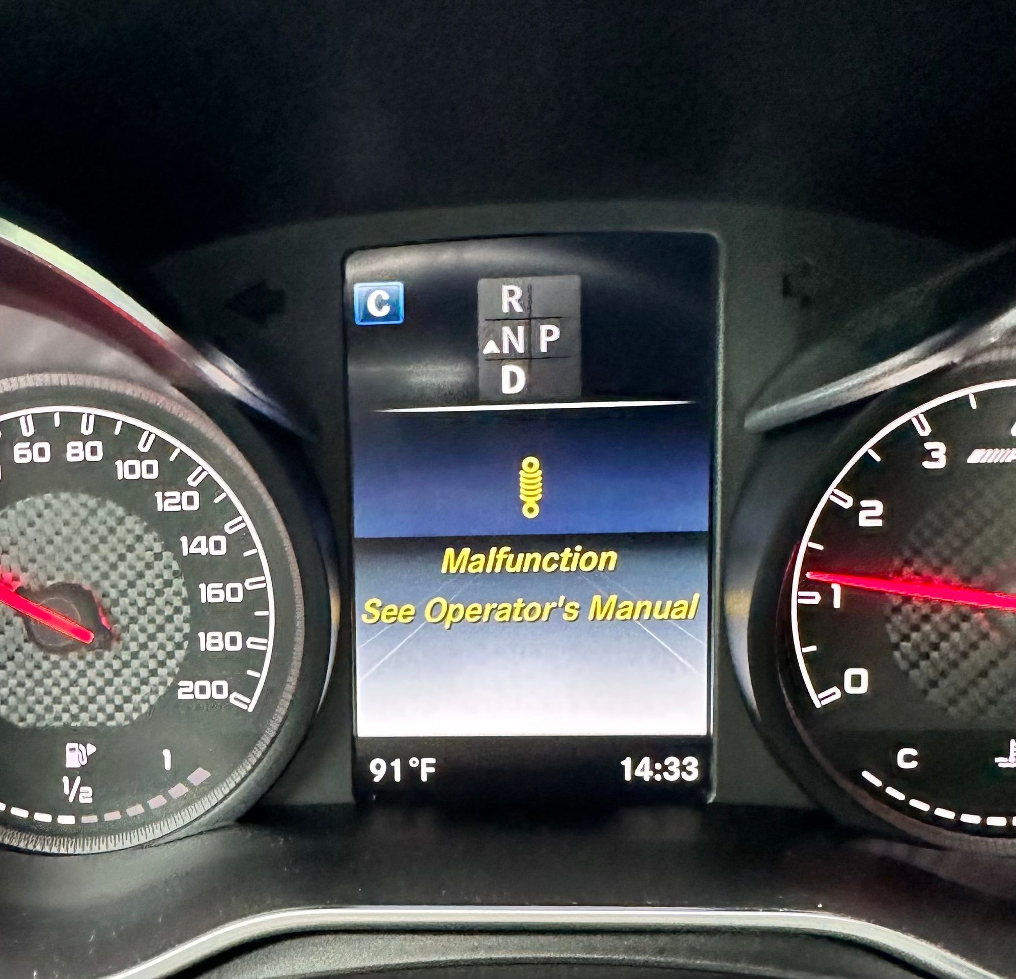

2019 AMG GLC 63 Warning Light
Can’t find this warning in the manual, pretty explanatory not sure why it says check the manual. Curious have any other owners received the same message? Car has 22k miles ….wife was leaving Target and the light came on 2 miles from home. Looked at the front suspension it’s about 1.5 inches lower than normal ……my guess air suspension leak or sensor. Will take to my indi next week, but curious if anyone here had the similar issues?

Did you find out the problem? This just happened to my 2019 glc 63 at 38,000 miles.
Yes, crack in the line to the pump which was losing air pressure so the compressor was over worked. Fix new line and new compressor, all in cost was 1500.00 dollars. Don’t have the dealer do it will be double the cost! I have a real good INDI and the trouble shooting took awhile to find the leak.
