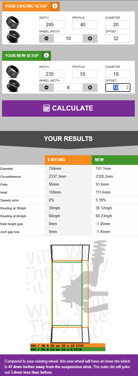

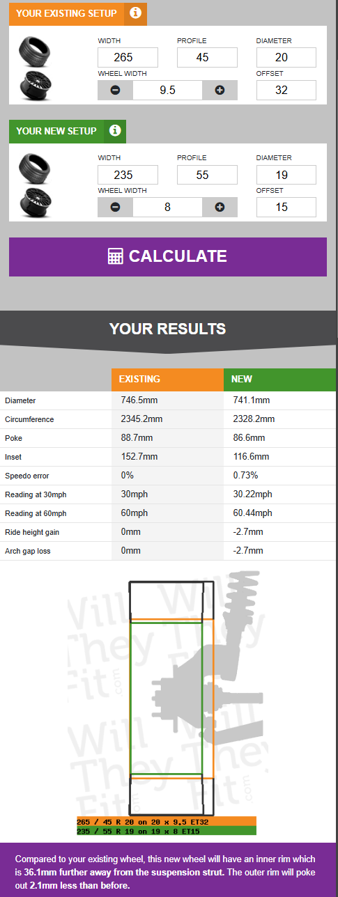

Thank you for the input, that's helpful. Based on what I seeing on willtheyfit.com, there is less than 1% difference in speedo. I changed the offset to ensure they line up somewhat to the same position as they are now, let me know if that is incorrect. I did find decent tire options for the 19" - Michelin X-Ice Snow and Bridgestone Blizzak both having a speed rating of H (130mph). With the 20" tires though both Michelin and Bridgestone have tires with speed rating of V (149mph), so there is that.
