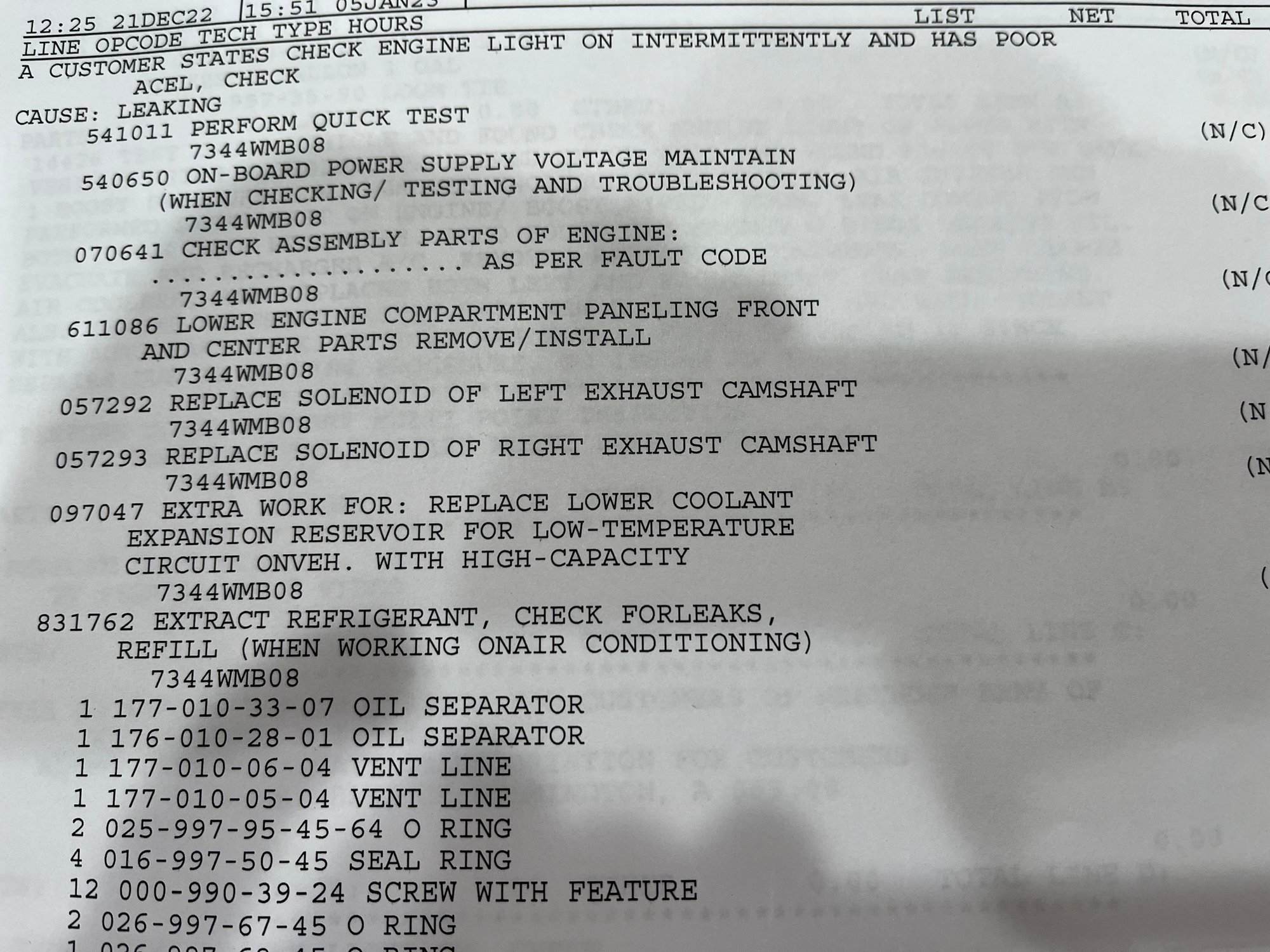

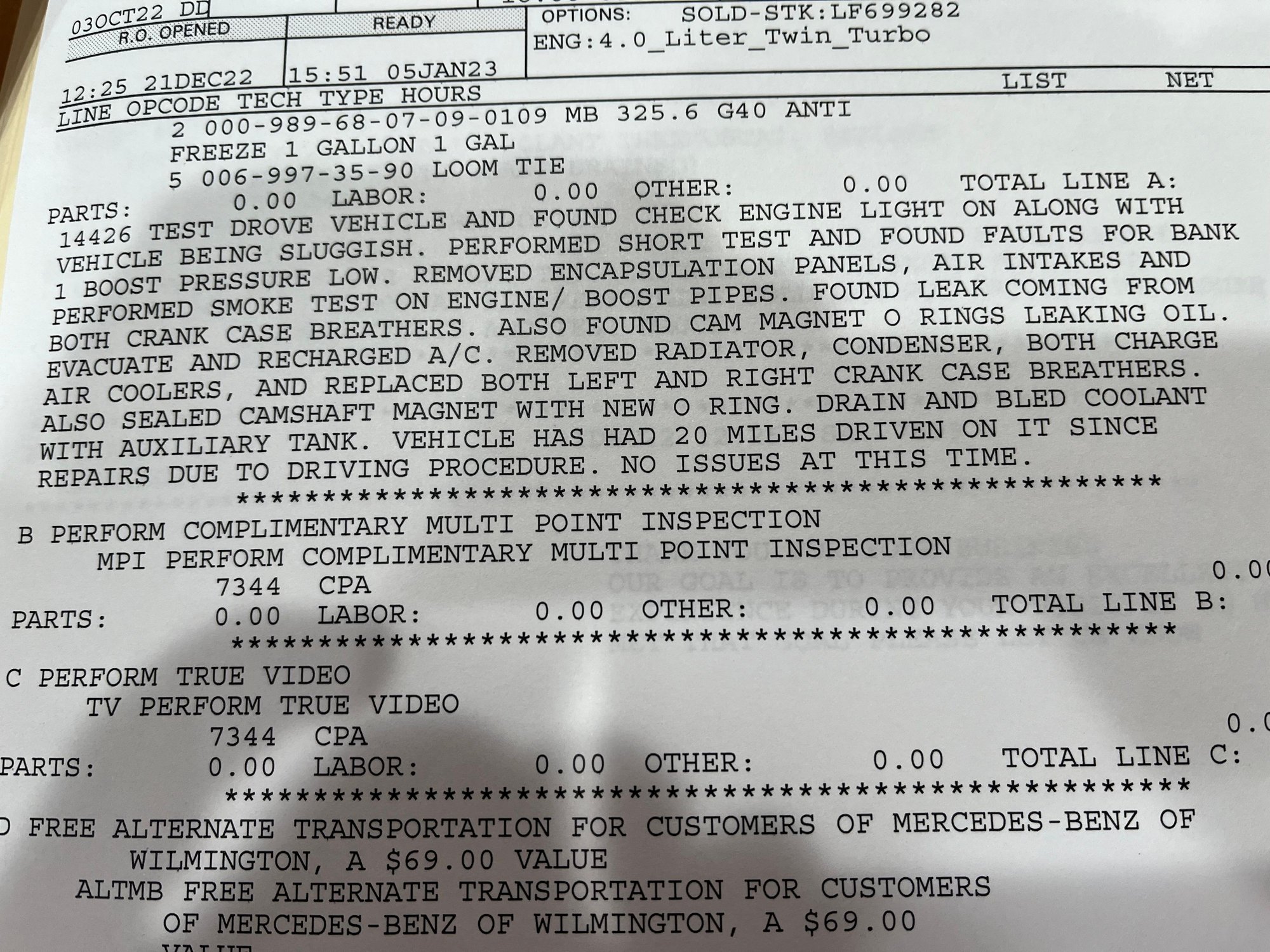

Here is the 2 services done for the CEL
I redacted personal information as advised by my lawyer "chassis" LOL

The service department called me today and they confirmed the car is not running right.
They pulled all the codes and are:
1 - Replacing the thermostat
2 - There is a boost pressure leak and they are going to fix that also.

Shlick96 on the C63 w205 forum, you are the man with great advice.
1- they replaced the cam magnets while they were doing the work.
2 - they replaced the thermostat
3 - they found boost leaks at the crank case and other leaks while they were in there, so they replaced all the lines.
The tech told the sales manager I will be very pleased and that is is an animal now.
They said it was not making much boost before and it was performing terribly when they got it.
Will update when I get to drive it.

I got it back this morning, it is rainy, but the car feels spunky.
Also, for the 1st time my temperature gauge is 208.
Here is the work that was done, pretty extensive.

How the f did all that get past the CPO inspection? Maybe it was remotely inspected over Zoom due to COVID protocols
Looks like you found a great dealer and service department though, they really went through that car thoroughly.
