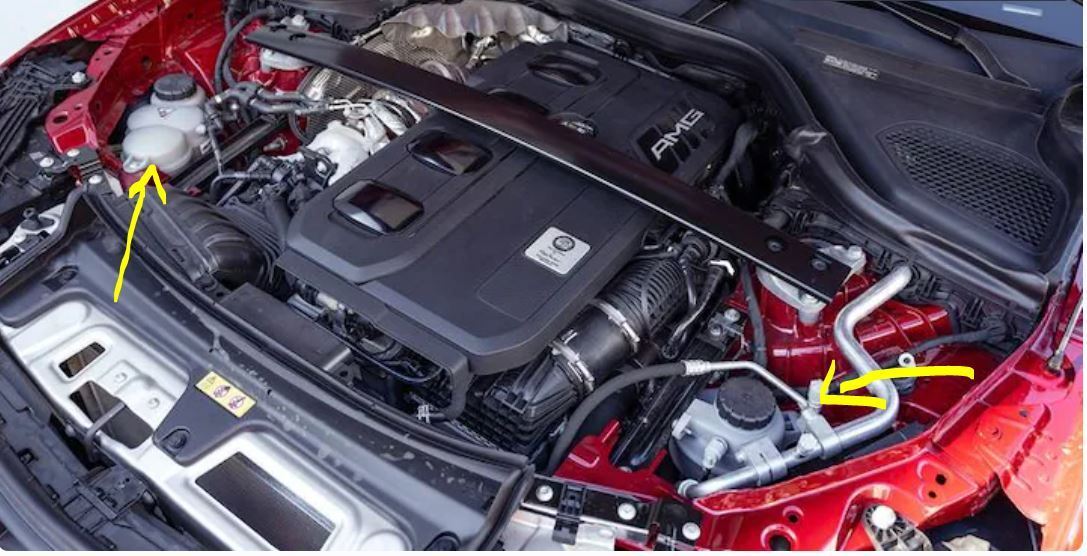

Do we have 2 coolant reservoirs in the GLC43 ?
I checked with my mechanic and the fluid in the right hand side was also pink.
https://cimg6.ibsrv.net/gimg/www.mbw...d7e0572101.jpg
Yes, many MBs have two, this is the norm. Just don't mistaken another brake fluid one as one of them though.

there is a diagram online of the reservoir on the right being the battery coolant system and the engine coolant reservoir being on the left.
Interesting can you send....
