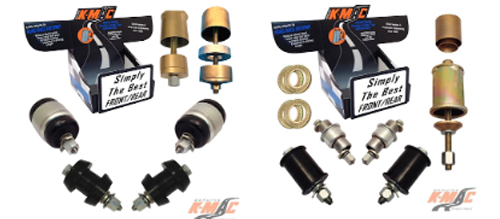

Yes today's models cost cutting and ever increasing speed of new car assembly lines front Camber (and Caster) along with rear Camber has been deleted.
Now the often quoted reassuring “Full Front & Rear ‘4’ Wheel Alignment” is only basic Toe “directional” adjustment.
Camber & Caster are fixed at one (showroom height) setting. Onus now back on owners to fund costly, premature tire replacement !
Yet essential - daily commuting and encountering high cambered roads with excess passenger side edge wear. Or inner edge wear both sides through extra passenger loads or lowering. Excess “outer edge” wear through spirited driving. No longer the ability to compensate for curb knock damage.
We saw the need therefore and manufacture “BOLT-ON” front and rear kits. Specially designed with bush extraction tools so no special tools required or the need for time consuming control arm removal.
Unique K-MAC patented design also allows precise single wrench - easily accessible adjustment. Ultimate direct on alignment rack UNDER LOAD.
SEE SPOILER Re front and rear kits all C253 & C254 GLC Models

Did you ever reduce the negative camber? I'm on the fence about installing some of the k-mac bushing to reduce the negative camber but can't seem to find much about the results and what they set the camber to.

I'm strongly leaning towards the k-mac caster/camber kit to reduce the caster as much as possible and increase camber to just barely negative, and go from there.
