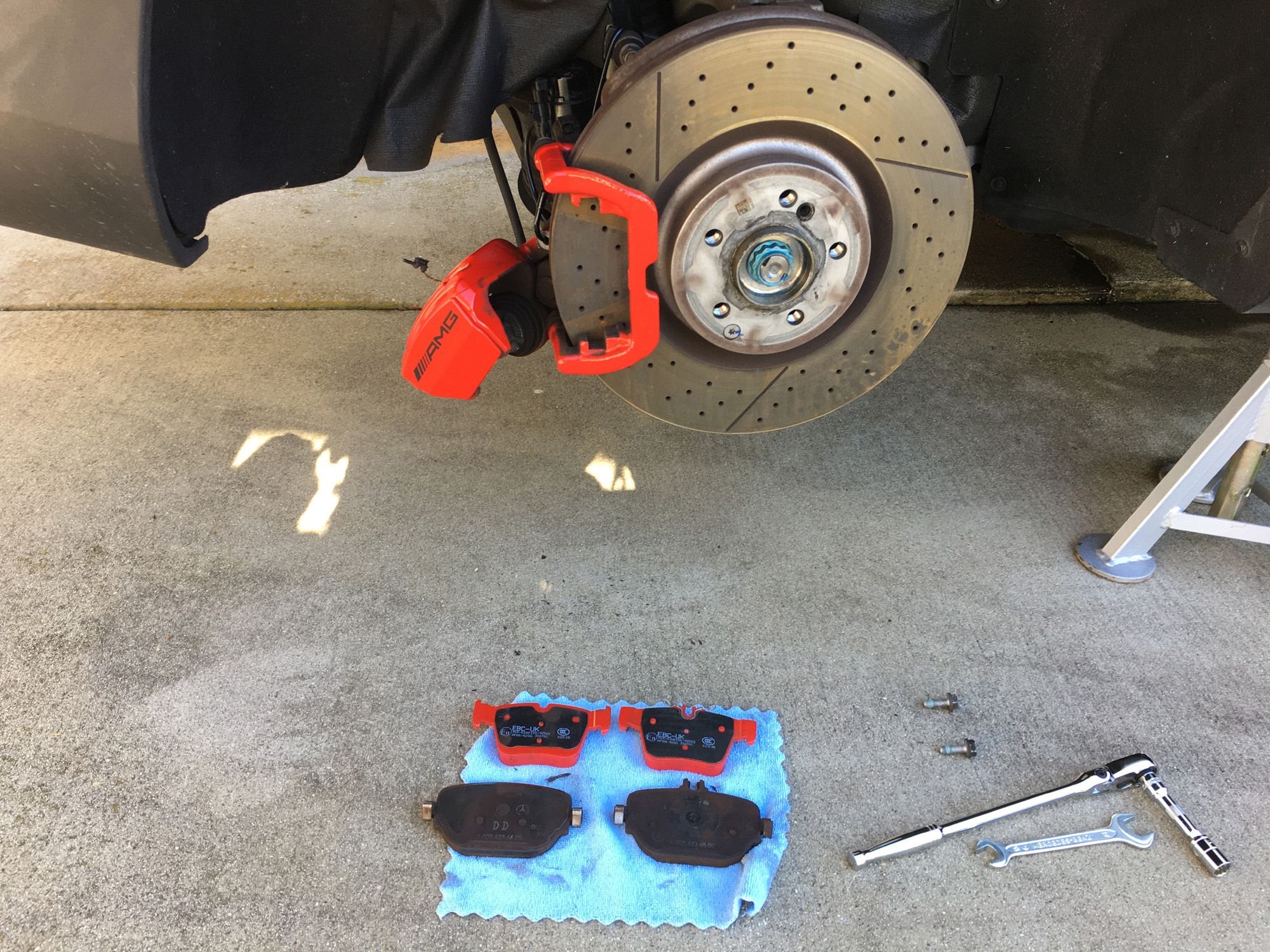

I ordered EBC Redstuff DP32270c brake pads (rear) from FCP Euro and on their site it said it is confirmed fitment for GLC63s (red calipers) but when I try to install it the pads appears to be a different size and shape from stock. I looked at different sites selling the EBCs they also said it fits, so what gives. Need some advice here.

Our rears take DP32314C. I just ordered these myself. What you ordered are for GLC43 platforms.

I just looked up the part number you gave and there it is on FCP Euro! Thanks for much for your help.
