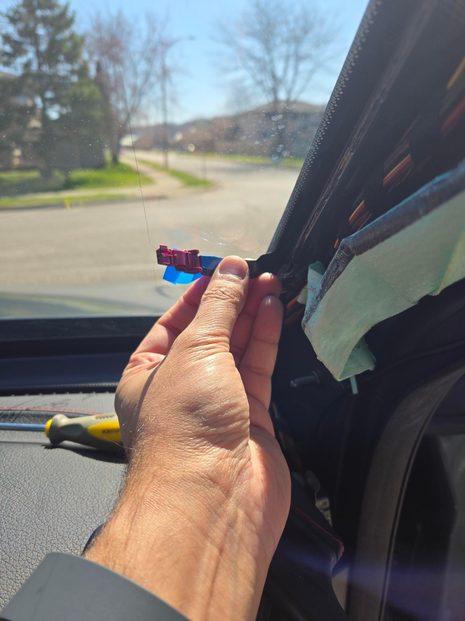

When I owned my 2018 GLC43, I found and successfully eliminated some rattles inside the vehicle. Lot of the rattles happened while driving on potholes or when the road resonance matched with vehicle, especially on highways.
1. Installed foam pad with sticky back inside front cup holder base and storage area to eliminate material hitting the plastic and rattling. Bought the foam pad from Michaels. But you can find it at Walmart or Amazon. Also installed it inside the sunglasses holder.
2.I noticed metal rattling inside the rear C pillars in the trunk area. I opened the covers and located it to the seat belt assembly. Unfortunately it is a Mercedes feature. There is a small metal ball inside a plastic cover and the ball is there for safely operating the seatbelts during a vehicle rollover. I cannot change anything on the seatbelt assembly but I unbolted the whole assembly and put some towels/padding and bolted it back in, so that the vehicle vibrations get dampened and do not transfer to the seatbelt assembly.
3. While installing the dash cam wiring inside the A pillar, I noticed a spare electrical clip that was floating and hitting the metal pillar causing rattling while driving even on somewhat smooth roads and highways. It did not look like it was going anywhere and had a blue tape on it. I added more tape and taped it to the A pillar. Photo attached.
