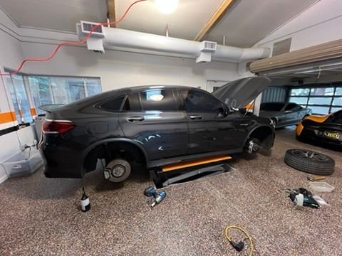

I'm doing a brake job on my '21 GLC63 (rotors/pads/fluid flush). Fronts were straight forward. I'm hung up on the rears because my current dx tool doesn't seem to want to retract the EPB. I have a Launch 741... I forget the version. It's functionality is painful at best and after wandering through, I finally found the parking brake...... but it wouldn't communicate with the car. After 8 tries, I through the towel in and almost threw the unit.
My question is what dx tool are you guys using? I just looked at I car soft and it seems like it may work. What have you guys had the best results with? Thanks!
