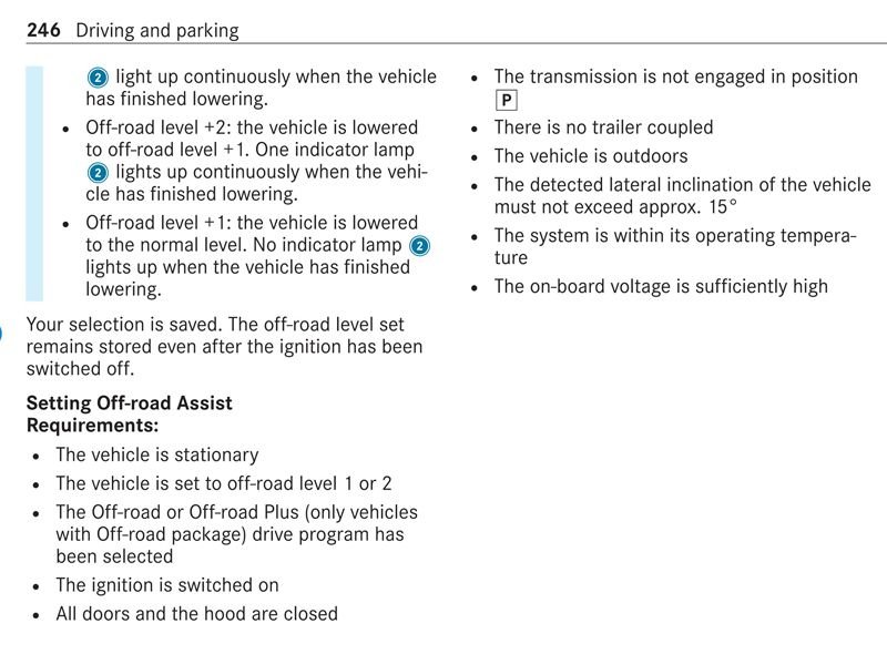

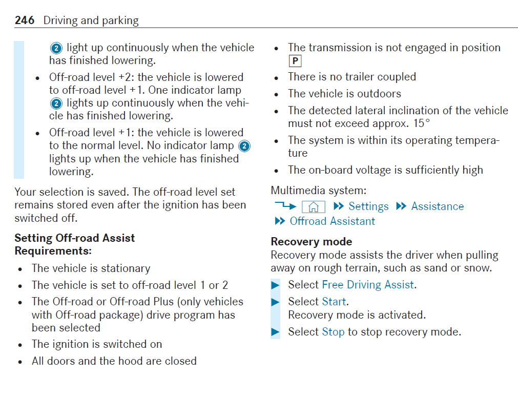

Our 450 has EABC but not the offroad package. Recently, my wife has complained that the ride has become harsh. I am not too sensitive to these things but it does seem different to me also. Air suspension is working, and raises and lowers on command. However, the offroad assistant shows as "Function unavailable". Yes, I have set all the preconditions as specified in the manual. I have tried every combination of settings (N, D, +1 level, -1 level, etc.) but nothing brings that offroad assistant to life. Any ideas?

In order to use offroad assist, you have to be in offroad mode in the drive program.

Seems like if there were a system fault you would get an error message. There are so many preconditions it would be easy to miss one.

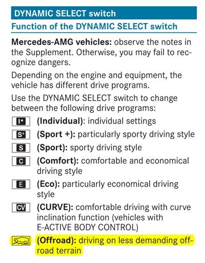

You don't need the offroad package to have the offroad mode. The offroad+ is what the offroad package offer. The normal offroad mode is available on all others. I have the same car as you (450 with E-ABC) and it does have the offroad mode.

If you have E-ABC then you have the Offroad drive program. You access it through the Dynamic Select toggle switch on the console

Got it. Somehow I was missing selecting the off road item from the Dynamic Select menu. Thanks for the instructions.
