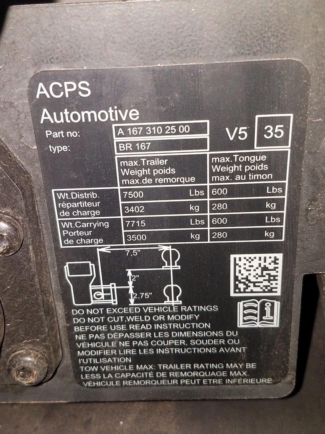

The “class” of the hitch (I, II, III, IV, V) is not the important number, the important hitch number(s) are the weight carry and weight distribution limits (along with tongue weight of course). These numbers show the hitch’s maximum weight limits for the specified hitch configuration (weight carry or weight distribution). If the weight carry limit for the GLE’s hitch is less than 7700lb, say 6000lb in the case of the Drawtite-Hitches hitch, it would not be safe to tow 7700lb. The weight distribution configuration (10,000lb limit for this example) may be required to tow the 7700lb with the GLE. I have not looked at the GLE’s hitch, these are just examples.
The 7700 lb towing capacity is simply one element in determining what can be towed safely. There are other component limits to consider. For example, Mikapen brought up the limits on single axle weights which could limit the max towing to below the 7700lb via the tongue weight. If you put a lot of “stuff” in the back of the GLE, that “stuff” and the tongue weight may exceed the rear axle limit of the GLE. Again, this could make towing 7700lb unsafe. You also have the GCWR, or gross combined weight rating. This includes the weight of the loaded vehicle and the loaded trailer. It is also required that the ball on the hitch be rated high enough to handle the trailer. Other considerations are mentioned in the manual.
<snip>.
Attached is a picture of the hitch label on our GLE450. It's exactly the same as on a 350 loaner we had this week.
Notice the diagram showing the max distance from the ball to pin, and drop and rise specs.
As far as a GCWR, I don't think there is a Euro car that publishes that number.
I still go back to the Front and Rear GAWR (Gross axle weight ratings), because I use a WDH and transfer a significant amount of weight to the front axle (and simultaneously back to the trailer axles). A trip to the scales to weigh axle loads independently is important to make sure one end isn't overloaded after adjusting your WDH.
Another point: no matter what your hitch reads, your capacity is limited by the weakest link in your tow system. It may be the ball, the ball mount or stinger, an axle, or the payload (located on the driver's door pillar).
I agree, figuring out what you can safely tow is not as simple as looking at the door. I do not think I have ever seen where the Wt. Distr configuration had a lower capacity than the Wt. Carry configuration, I find that quite interesting (or maybe in error). I found the ACPS Automotive website (haven't really looked at it yet) and if I can find their customer support, I will send them an email to confirm these numbers and hopefully get an explanation.
Yes the numbers certainly don't fit the norm. I'm guessing it's a Euro translation thing, or their unfamiliarity with WDH's in general. My TT is 6,000# so I'm within hitch specs AND GLE max.
Let us know if you get some insight.
I filled out one of the "contact us" forms on their website but it is the weekend there so I don't expect to hear from them for a bit. I said their numbers where reversed from all the other hitches I have looked at and ask them to confirm the numbers. Also if the numbers are correct, why are they reversed. Should be interesting if/when they respond.

Well, ACPS Automotive responded today:
Hello,
This hitch is Mercedes-Benz Original-part.
Please contact the local Mercedes-Benz-Dealer in this matter.
Freundliche Grüße / Best regards
Gunter Holzapfel
Customer Service
T +49 7142 9930 138
F +49 7142 9930 322
E gunter.holzapfel@acps-automotive.com
ACPS Automotive GmbH
Advanced Carrier and Protection Systems
Bertha-Benz-Str. 2 . 74379 Ingersheim
I guess I have been adequately blown off.
