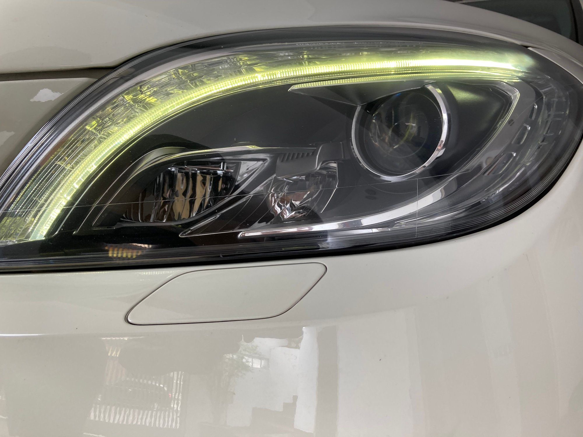

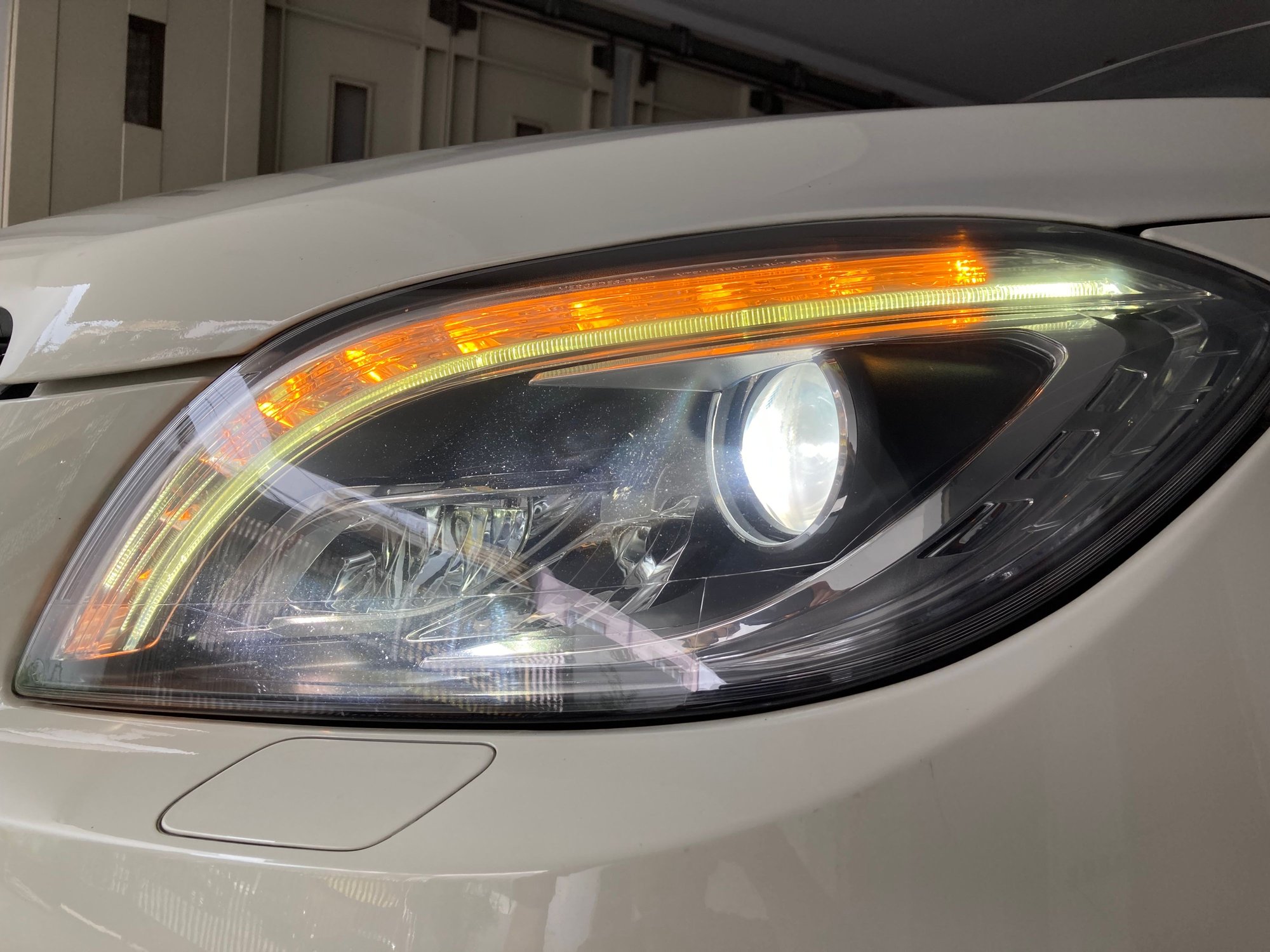

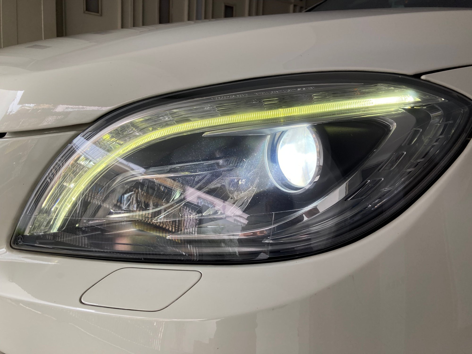

Originally Posted by GregW / Oregon
My 2012 ML350 w/ bi-xenons had functioning cornering lights (separate lensed light sources):
I also took some pictures of our W166 ML250 with Intelligent Light System (the previous version of MultiBeam LED) with cornering lights, and I just realized W166 in the US also had their corner lights plugged according to Greg's picture above.
Here's what I have:
Experimented with the lights on, without blinker (cornering light off):
Blinker on, cornering light on:
You can make out the glare from the lit cornering light on the bottom corner.
