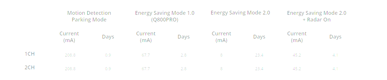

There are differences between the parking mode of the Blackvue and Thinkware.
For Blackvue, there are 2 options. Regular parking mode (video on, but only record with 5-10 seconds buffer before event) or time lapse mode which record 24/7 with 1 frame per second. Both requires the camera to be on 24/7 in order to record/detect event with buffering.
For Thinkware, the new Energy Saving Parking Mode 2.0 keep dashcam on standby mode, and only record the second an impact is detected. This means that only the accelerometer is active during standby. You can pair it with the radar module which could provide you with up to 10 seconds before an impact (with motion sensor)
Here is the current draw chart from Thinkware:
