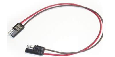

I hardwired a 12V Anderson plug to mine to make it more universal. I use it for a compressor, inflator, battery charger, and solar panel which do not all run on a low amp 12V cig lighter plug.

I haven't done it yet on the new car, but in the past I have connected a Battery Tender (Deltran) adapter to the battery points under the hood, then run the end out to the grille. Battery Tender uses "SAE connectors" which, like the Anderson above, are widely used in RV solar applications. They can be found at Battery Tender (wide variety) or universally online, in lots of wire gauges.
I wouldn't try to mount the charger itself under the hood - just the wiring. https://www.deltran-global.com/Ring-Terminal-Harness
