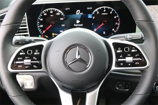

Got the 2021 GLE350 without Driver Assist Plus package as this was the only one available and I could not wait. Question, Is it possible to enable the Drive Assist Package after purchase? Car had all the hardware needed. If BMW can do it, why MB cannot.

Even if all the cameras and sensors are included on a vehicle without the feature (doubtful), the Steering wheels are different. I don’t think any dealer would be doing this without replacing the steering wheel too and that would be thousands.

The car without the Drivers Assist pkg doesn't have all the necessary hardware. You are missing the radar unit that sits behind the star in the grille, among other things.

You can retrofit Distronic to it. Coders sell the kits but that is only one of the features of the drivers assistance package
